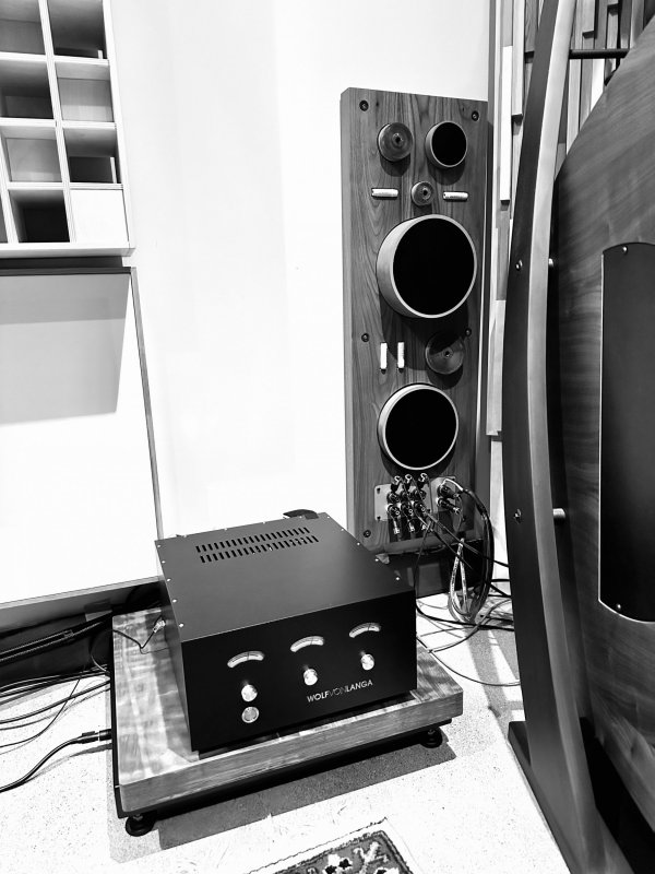

Another update on the benefits of reducing field coil power supply vibration:
I recently installed the @Seismion Reacto active isolation base. All I can say is WOW!
On a track I play often (Theme from The Godfather, Sound of Movies), I can now hear the breathes taken between notes from the lead trumpet. Notes sound more "alive" and "stable" in the room, especially during dynamic and loud passages. Focus, on mono tracks for example, is considerably improved.
Once you've heard what an active isolation base can do, there's really no going back.
Of the available units, Seismion makes the best. From those who have compared it directly (there's a thread about it here) to others, it's seen as the best. It also costs considerably less. (Taiko made one, called the Tana, which was ~4X more expensive and it's no longer available - perhaps that one was better).
Here is the WVL field coil PSU sitting on a Taiko Daiza base and that is sitting on the Seismion.
If that supply is running Tungars this is no surprise.
Indeed but it’s not. This is a solid state supply! Transformer, Lundhal choke, caps…
Stamped steel chassis. Well built in Germany by Wolf von Langa, so this is not a low budget piece!
OK- I would not have expected that at all!
Me too! Completely unexpected.
I realize that $5k is not by any means cheap; but if you can try it I think it’s an easy buy, especially if it represents a small fraction of the total cost of your system. You can flip the power switch off to compare with and without vibration attenuation.
I think vibration control is the next frontier in high end audio — we seem to have reached the pinnacle of AC power filtration and ground noise reduction.
