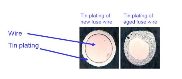

4) Pulse factor derating of the fuse wire. As a fuse wire is subjected to pulses of high current (everytime you turn your system on for example), the fuse wire ages. Here's a picture:
Obviously an aged fuse wire will break more easily, but we might also conclude that it won't sound as good.
