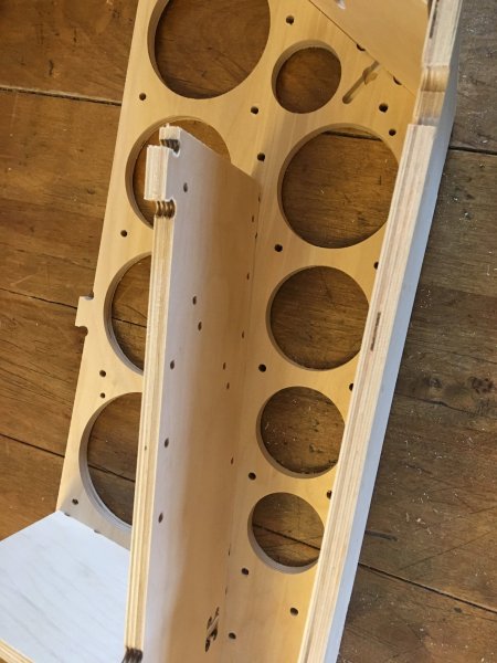

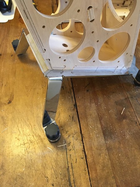

For example, Stiletto features twin-hull enclosures, where custom multiply (maple / birch) panels are machined and assembled with all mounting hardware to form a chassis. Then, the chassis is fitted with dressed panels, each of them decoupled from the chassis but also decoupled from each other adjoining panel. The resulting construction is both inert at low frequencies and highly damped at higher frequencies.
Drawback is a lower than average sensitivity of 82 dB, partly compensated by higher than average impedance.

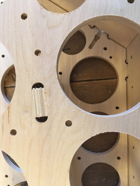

Picture of the chassis assembly: all panels are interlocking. Once assembled, the chassis is both light (higher natural resonance) and extremely strong, thanks to the multiply made of birch (soft wood) and maple (hard wood). Each wood layer changes material impedance. The larger holes create a non-flat surface to scatter any standing wave, while the smaller holes are all filled with a special damping compound that never dries out.IMG_1442.JPGIMG_1433.JPGIMG_1442.JPGIMG_1453.JPG

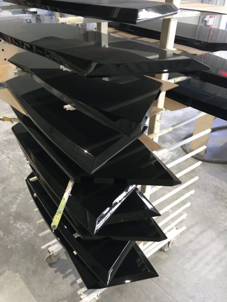

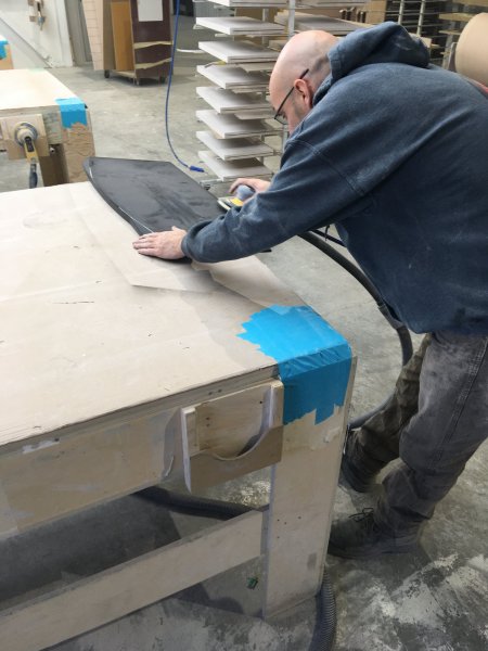

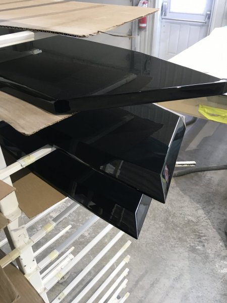

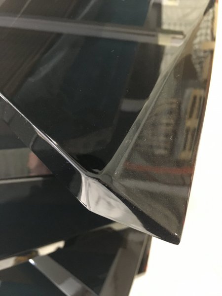

Dress panels are lacquered in a multi-steps real piano finish. Unlike automotive finish, multiple coats of polyester laquer are applied with hand sanding between each coat. 4 coats of primer followed by 8 coats of solid black laquer, followed by 3 coats of black-tinted polyester. The finish is deep and hard. Polishing is done after 28 days of curing time.
