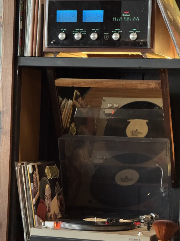

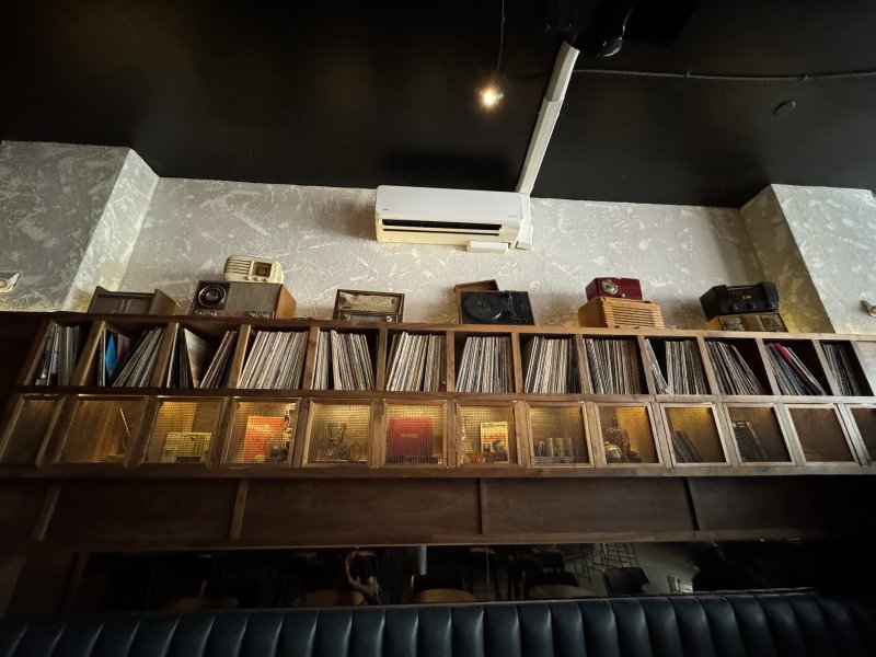

At Harlan Records, a groovy cocktail bar in SF, where they play vinyl records on a McIntosh system. What’s not to like?

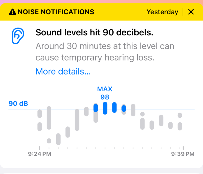

So, I heard the San Francisco Symphony last evening conducted by Esa-Pekka Salonen. The highlight was Stravinsky’s ballet The Firebird. Scored fir a massive orchestra, with a huge brass section, some of whom were arrayed around Davies Hall, three harps, a huge woodwind section, the full gamut of strings, this was a sure fire crowd pleaser. And at the end of the 45-minute piece, the audience of more than 1000 erupted in applause, and the standing ovation went on for many minutes.
Many points that Steve made I found myself nodding at. When the bass drum is first played during the piece, your heart just stops. It’s like a massive thunderclap that echoes through the hall. At climaxes, the decibel level in my side box near the orchestra was over 100 dB as measured on my Apple watch. My watch gave me an alert warning for excessive sound levels.
But the quiet sections, beginning with first murmuring of the double basses in the beginning, to the gentle strumming of the three harps, to the gorgeous solos for English horn were just as delightful.
No, I don’t think my SL G9-7c can reproduce the dynamics of the orchestra playing Firebird. That said, I don’t think any speaker exists that can do it. I’d be terrified if I played music at those decibel levels. It would shatter my windows. Plus I’d quickly grow deaf if I listened every night at those sound levels. The live experience remains unmatched in my experience. That’s why we go to live unamplified concerts in a real hall. Amazing concert that also featured the Alban Berg violin concerto.
Warning from my iPhone on excessive sound levels during the Firebird concert last evening. You don’t want to listen at these levels if you want to keep your hearing.
