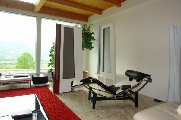

Hello together
I'm new to this forum. Bonzo pointed me into the direction when he was at my place to listen to my Apogee Studio Grands.
I do (and have) own(ed) several different Apogee Models and have heard pretty much all of them.
There are still some pertinacious preconceptions that Apogees in general are from hard to almost impossible to drive for the connected amps.
That is very true in the case of the dreaded 1 Ohm Scintilla (between 0.8 Ohm and 1.1 Ohm over the whole frequency range and quite low sensitivity) and also the FullRange is rather hard to drive, but only when you want to drive them directly, without the passive x-over for the midrange-tweeter-part and without the resistors to the bass-panels.
The Studio Grand (and the Studio Ribbon Array) on the other hand is the easiest to drive model with a purely resistive, linear 6 Ohm over the whole frequency range and a quite high sensitivity of about 87dB/watt in 3 meters distance (not 1m !!).
I drive my Studio Grands (without the integrated Subwoofers) in my huge living room with only 30 Watts per channel from my KR Audio SET amp to volume levels, I don't want to listen to for longer than half a track.
Because of the pure resistive load of the panels/ribbons, Apogees (except Scintilla and FR) are a rather easy load for the driving amp.

Beautiful room and system! Is that a Lamm monoblock or a KR SET you are using to drive your speakers?

Hi LL21
Thank you for your kind words.
The speakers you see in the foreground are completely to my ideas overhauled Scintillas. They have an new welded and braced steel frame, are augmented to have the sweetspot on ear-level when they are completely upright, new x-overs with better parts. These babies now weigh 120 kg each :D You see Justin, I had similar ideas like you, just a year or so before you :p
They are 1 Ohm and can't be driven by SET amps. For them I tried a wide spectrum of amps (Krell KSA100 Mk2, Musical Fidelity KW, Sphinx PJ) but the Lamm M1.1 worked by far the best.
The speakers you see in the background are Studio Grands (rather Studio Ribbon Arrays because I don't use the integrated subs) and these are the complete antipode with linear 6 Ohm impedance and a quite good sensitivity compared to the "almost-impossible-to-drive-well" 1 Ohm Scintillas. The Studio Grands sing beautifully with just 30 SET watts from KR Audio in my huge living room :cool:
