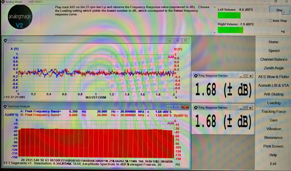

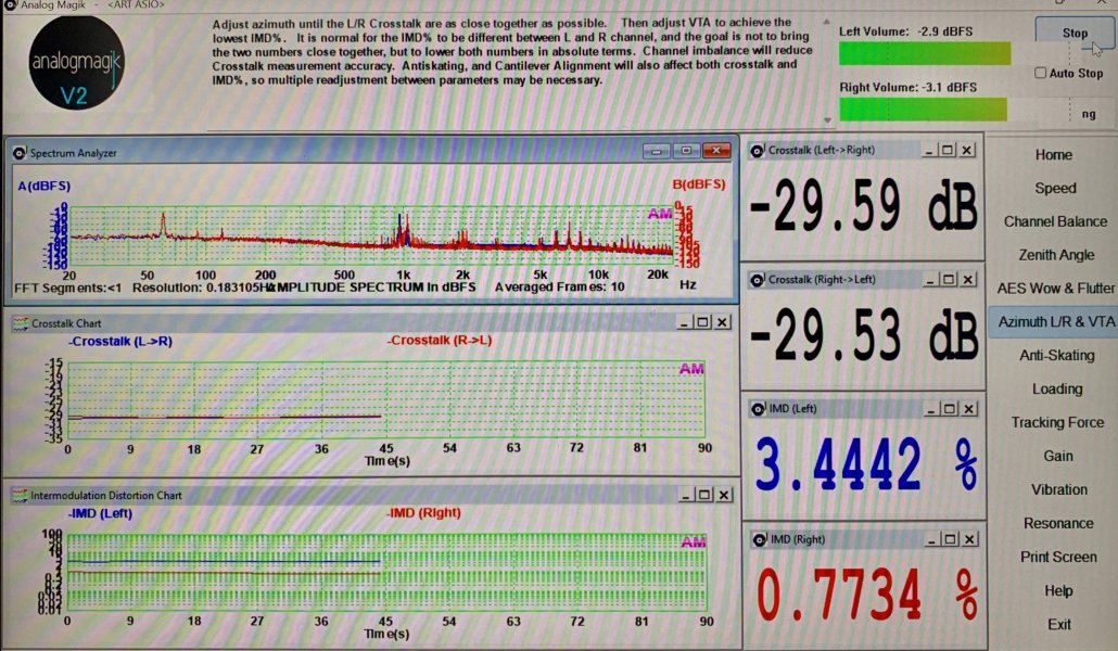

Here is an alignment I did yesterday with a fuuga on a 4 point. I am getting a very flat response with good separation and low imd. I don't know why left imd seems to be high though.

so only a couple of data points but they are consistent i.e.3 users are showing left channel distortion higher than the right. Janbra's report about azimuth differences is also cause for concern...

It's says right on the screen that it's normal for L and R IMD% to be unbalanced and the goal is not to bring them into balance but to reduce both numbers in absolute terms. Sure, it'd be enlightening to hear from Richard as to why this is, but presumably this is an artifact of how the test track is (intentionally) designed. Given that it's "normal", I guess I don't know why we need be concerned?

It's says right on the screen that it's normal for L and R IMD% to be unbalanced and the goal is not to bring them into balance but to reduce both numbers in absolute terms, Sure, it'd be enlightening to hear from Richard as to why this is, but presumably this is an artifact of how the test track is (intentionally) designed. Given that it's "normal", I guess I don't know why we need be concerned?
It makes no sense to me that it is "normal" for distortion in one channel to be 3 to 4 times higher than the other. Just because the screen says it is "normal" doesn't mean it is right. Maybe it makes sense, but in V1 I can get distortion in both channels to very low levels. Not just the right.
I don't think it is unreasonable to wait for an explanation before investing . But maybe that's just me.
