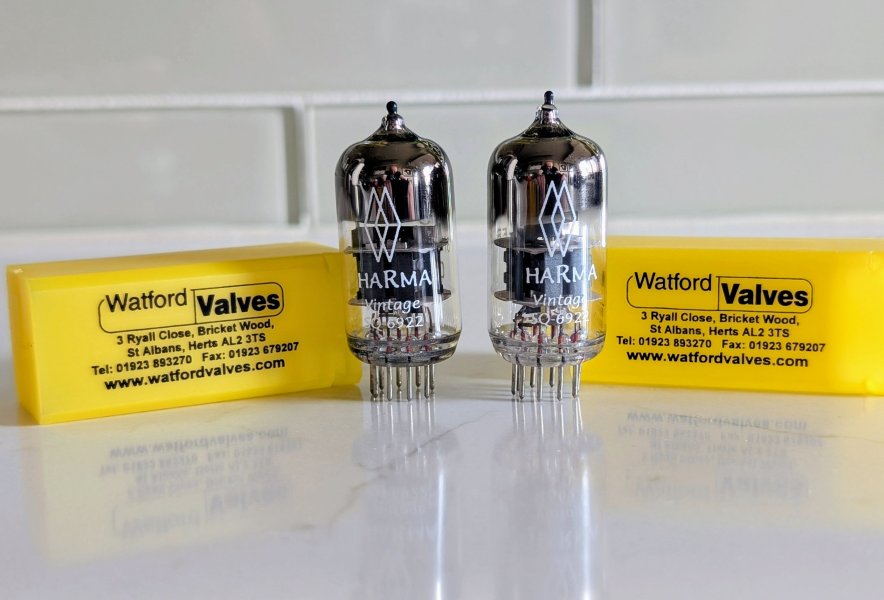

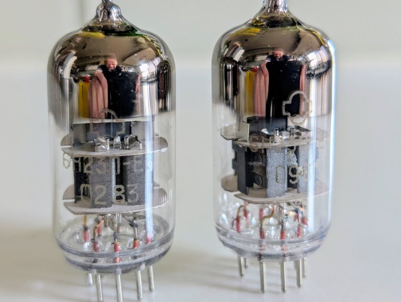

Be careful with those, they can sound good but have a different plate current, i have had them burn out in the Io. The earlier version that do not say EV or EB are better suited for our Phono.
Thanks. I’ve always wondered why the discussion on the Reflektor tubes was sometimes positive and sometimes not.
25 years ago these were being sold as drop in replacements, which they are not.

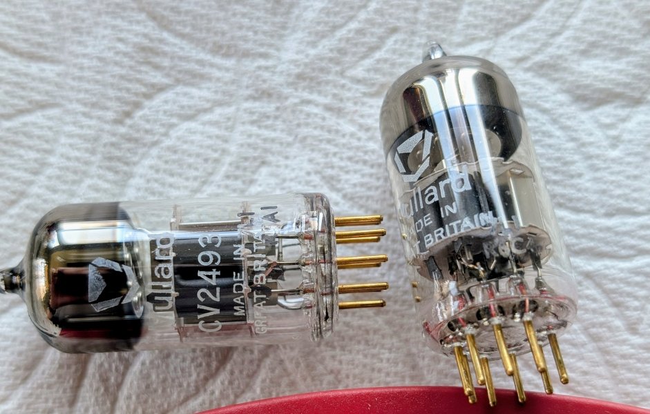

IMHO, I recommend the Mullard CV2493 dimpled, followed by (in order) Mullard E88CC/01, Valvo CCa pinched, Mullard 10M, Amp 6922 pinched.
Tube preference could depend on sound preference, other tubes synergy, and system synergy.
I have Mullard CV2493 to try, they are 1970s. I suspect you are referring to the 1960s version. They are difficult to find and priced accordingly.
Actually, I also have the 1970s Dimple disk (D-getter) tubes. I have not seen any of the 1960s Halo (O-getter) tubes.
I have a fairly large section of tubes. The 1970s D-getter CV2493 were the best tubes in IO Signature, Calypso Eclipse preamp, and Canary KD-2000 MK2.

These are 1975 and 1976 with dimple disk getter. At some point, I got several pair from a bulk pack. These are Mullard label CV2493. From what I understand, there was a 1960s Telefunken CV2493 that is supposed to be very nice.
