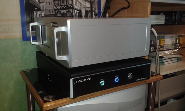

Below is a photo showing the two platforms tested (Accurion i4 and Herzan TS150). That mediocre all-wood table is for photo-taking only. The two platforms were tested on much better hifi racks.
I will post the findings in the following post.

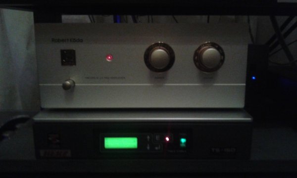

There are many photos. Here are just a few on different frontends.
We tested the platforms on preamps too.
Poweramps were not tested. They were heavy and we didn't have enough time.

I like how the herzan has a graphic led allowing visualization of the vertical, left and right horizontal vibration planes. The Accurion has no such real time information....unless significantly cheaper than the table stable I will stick with the same.
Yes, Herzan has a led screen and the vibration detection/monitoring function and weight distribution function are useful and convenient.
Therefore, after the gathering some of us will buy Accurion and some will buy Herzan.
