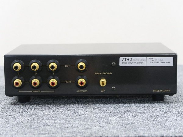

Anybody have experience with this SUT? I am on the lookout for a SUT. It has three inputs so it seems ideal for multiple tonearms. It also has a good range able to match those very low impedance cartridges like the MSL ones.

It’s a superb SUT but it is somewhat more sensitive to hum from surrounding components so you have to take more care in placing it.
Thanks. Always wondered whether it made sense getting a general SUT like this or a manufacturer specific one, i.e. MSL SUT for MSL cartridges, Ikeda for Ikeda and Ortofon for Ortofon. I have a Ortofon SPU Century, Ikeda 9GSS and Ortofon Anna that i might need boosting.
A specific brand SUT for the same brand cartridge is nothing more than marketing hype. The Air Tight SUT will accommodate any cartridge on the planet.

Howiebrou,
I'm very happy with mine (frankly I'm unsure whether I've got the "reference" version, though).
Works well with Very Low Output cartridges, such SPU Century, KOETSU Platinum Generators, the IKEDA Mono and since a few days even with an EMT shellac cartridge. ;)
The “Bypass” (Direct Input) additionally allows to connect an MM cartridge to the MM RIAA Phono Stage
I admit, I have no experience with other "high-end" SUT's
Regards
Urs

If one has multiple carts, it’s very convenient to have more than one impedance input setting. For performance and cost I very much like the EAR MC-4, though inputs are not switchable. One reason I use the Air Tight is its Bypass mode which makes it super convenient to use my high output SPU Mono GM MkII when I’m not playing my other SPUs.

Thanks Urs. I was not even aware that there might be more than one version. Air Tight's website seems to only have one.
