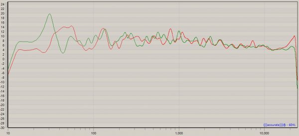

There could very well be nothing wrong with the electrical and that my problem is speaker/room interaction. Here's a measurement taken a few weeks ago:
Red is the left channel; Green is the right channel.
Depending on what music I play (e.g. Aja by Steely Dan), it sometimes sounds like the three woofers on my M-Projects aren't working (but of course they are) and that I have tiny bookshelf speakers.

What in the world is that weird graph?

As for the graph, need more information, like the frequency resolution in bass region, where you placed the microphone (on a tripod at ear level is usually best), etc. Can you do a sweep with at least 1/10 octave resolution or higher from say 1 kHz to 10 Hz? With both channels playing? It would be good to see the combined response to see if there are nulls impacting your sound.

I had a friend measure my room response and he did the sweeps per speaker. I did wonder myself what the combined response would be.
