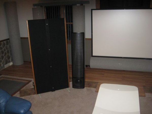

Still my choice
Magneplanar Tympani IV,s (modified) with Martin Logan Summits and the unbelievable
TRW-17 rotary woofer.

Great system, but unfortunately the structural work to build in the rotary sub is not an option for me, and I haven't space for the Tympani panels...
Where do you cross over from the Summits to the Tymp panels, and then to the sub? Are you using the woofer in the MLs?
I heard a lot of Tympani systems through the years and was a little surprised Magnepan dropped them. They do take a large room and that may be the main reason sales were low, and/or perhaps they decided the 20's did the job fine.

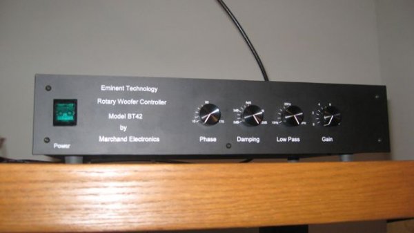

Velodyne SMS-1 and Eminent Rotary woofer controller

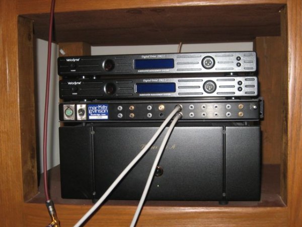

I use a Velodyne SMS-1 with different xover frequencies and slopes and chose
180 hz for the Magneplanars. The rotary sub controller is set at 25 hz, 12 db per octave.

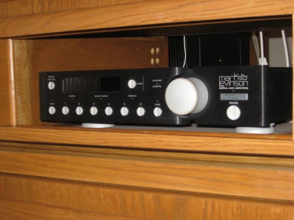

A Mark Levinson 380S preamp is used to control the level of the Maggies (.1db increments)
driving a Audio Research D400 MKII power amp. The Summits can be used with or without
the woofers.
