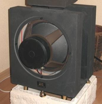

I had several subs, for example Dynaudio, Velodyne 12 DD+, Rhythmik
But by far the fastest, most accurate and musical sub is my actual: a Ripol Attac 400 designed by Axel Ridthaler
It is not very common but with two 18 inch face-toface-Drivers and one opening which is about 4 inch wide there are nearly no vibrations and the wave goes directly in one direction (as far as possible with low frequency waves)

Hi...I see you have listed 2 x 18" face to face drivers...the website says 2 x 12" drivers. The Celestion 6000 series sub was also 2 x 12" cones.
Are you definitely 2 x 45cm (2 x 18" inches) with your Ripol Attac 400 series? Thank you.

Hi i am so sorry - now i measured, not 18 but definitely 15 inches from Gladen, here is a picture of the front:
