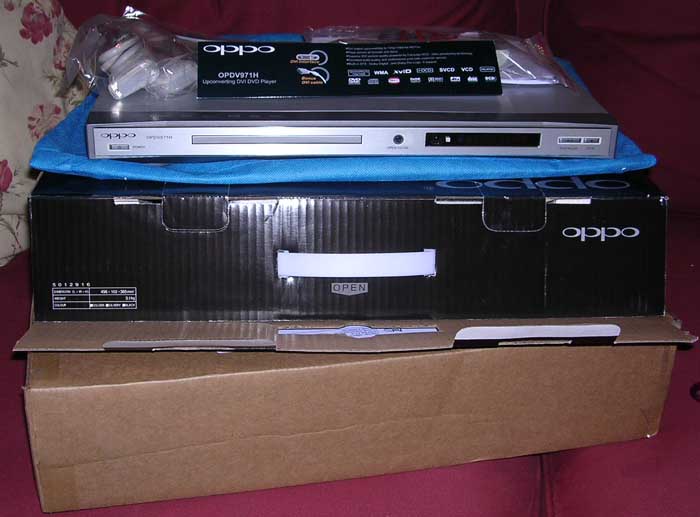

2. Yes, the Oppo DV-971H has the internal HDCD decoder (PMD-100 chip from Pacific Microsonics).
You can see the logo indicated on the upper advertising piece of promotion cardboard ? [HDCD] - Plus it has been confirmed.
It's there, inside ? rectangle larger chip ?
Of course now it is owned by Microsoft.
