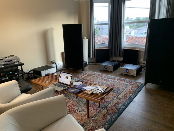

Without a doubt, shorter speaker cables are the better choice. This is done routinely with mono block amplifiers so that they can sit close to the speakers. IMG-1201.jpg
