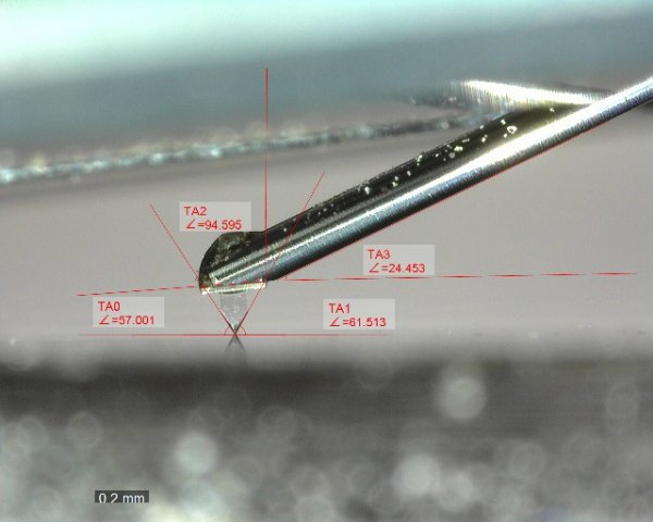

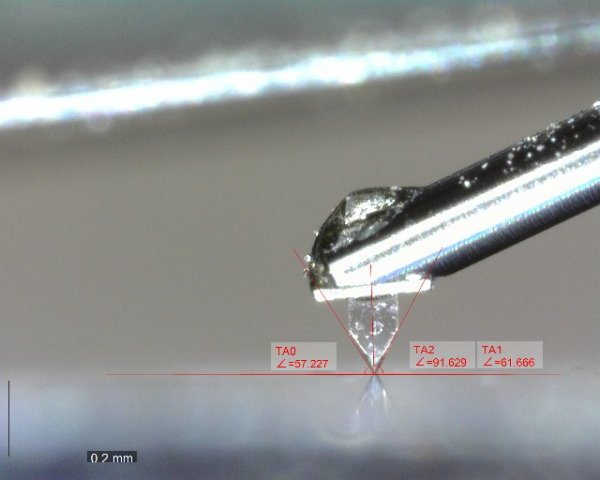

All,
I'm having difficulties with my Air-Tight PC-1s set-up; so I sent a private message to another PC1S owner, PeterA, and he suggested that I post a thread and include some pictures to see if someone can provide guidance. I have the cartridge mounted on a Graham Elite and my TT is an Oracle Delphi MkVI. My other cartridges are Koetsu's - an Onyx Platinum Diamond and a Rosewood Signature. Both cartridges sound very good, and I mention this only as a "reference" because I don't believe there are any downstream factors that are impacting the set-up and sound of the PC1.
When I mounted my PC1 and was attempting to set it up, I could not get my SRA anywhere close to the desired 92 degrees. Even with my VTA on the Elite raised all the way up, I could only get to about 88 degrees. At this stage, the cartridge didn't sound bad; however, it didn't sound as good as I was expecting. So I decided to shim the front of the cartridge and ended up using a small piece of bronze sheeting cut to about 4x10x1.5 mm (WxLxThickness). Bingo! I was able to get 92 degrees with the arm of the Elite very close to parallel. I've attached some pictures below taken with my digital microscope with the cartridge at 2.1g VTF.
When I played some of my reference recordings the cartridge didn't sound good at all - somewhat dead and lifeless. So if my set-up is accurate (all other set-up parameters are correct and in line with both Bob Graham's set-up tools confirmed with a SmarTractor), then what's going on here?!! Is it the shim material I've used? Is something wrong with the configuration of the PC1? There are quite a few embedded measurement in the pictures below that I'm hoping someone more seasoned than I can interpret and provide some potential recommendations and solutions.
Thanks much!
Kyle

Hey Billy - thanks for the response.
Regarding why happened when I shimmed and was at 92 degrees, everything collapsed, became restricted, and all the magic was gone. I'm not sure what was causing it and I think it wasn't the SRA but the interaction with the shim; but I'm not sure. The Graham Elite headshell has about a half inch circular soft "coupling disc" that the cartridge rest upon when mounted to the headshell. With the shim in place, the orientation and coupling between my cartridge body and the headshell became "compromised" - the cartridge was only seating on the rearward portion of the coupling disc and the forward portion had the brass shim between the cartridge and headshell. I'm not sure if it was this or the brass shim negatively interacting somehow; but be that as it may, I ended up taking the darn shim out. Couldn't stand it! And once removed, guess what happened? The articulation, bass and treble response, and ease and naturalness of the sound all returned. Go figure....
I didn't make any additional adjustments other than the VTF, getting my arm to parallel, and using Adjust + to dial-in my azimuth. I didn't want to mess around with the digital microscope as it's quite an ordeal to prepare and mess with it, and I knew from past attempts, I couldn't get it set to the proper 92 degree SRA anyway.
So what are my learnings here... Well, first of all, I do believe there is something behind Fremer's, and other's, touting of the 92 degree SRA. It makes sense and there are a multitude of advocates who agree with him. I believe that all of us realize that there is a certain range of tolerance here and that there is really no perfect "ideal" given the overall lack of standardization in the recording industry; however, the overall basis of ~92 degrees is sound. My other learning is either my shim was of the wrong material or it interfered with the proper cartridge-to-headshell coupling that I assume is also integral to the overall musical chain. And probably my final learning was to quit obsessing and just enjoy what I already have!
Does the PC-1S sound good? Absolutely; however, would it improve with the proper ~92 degree SRA? Maybe; but I guess I won't be able to prove that out unless/until I figure out how to achieve it without injecting other compromises into my system (i.e., shim) in order to attain it.
Kyle

David & Billy - Thanks for your replies and assistance. As David notes, digital microscopes can be problematic. If you're not set-up so the microscope is exactly on plane with the platter/horizontally, then all measurements will be off. I am aware of this potential issue and was able to get things properly aligned to the best of my ability. Does this mean that everything was exact? Probably not, and I'm sure my measurements may have been compromised a degree or two as a result.
As things stand now, I will cross-off shimming the cartridge/headshell from my list of solutions. Too many variables here and the interaction and coupling between the cartridge and the headshell are too important to compromise with a makeshift approach. Therefore, I believe I'm left with one other option - to raise (or shim?) my armboard. However, I'm concerned that this would result in my tonearm being considerably off level; in other word, canted down from back to front. Is this something that I should be concerned about, or will it matter?
One issue that I haven't delved into is the fact that maybe my PC-1s is off-spec and either the cantilever is set an an improper angle or the stylus is mounted incorrectly to the cantilever? Are there any other PC-1S owners on the forum who can compare the pictures I posted when I started this thread to some that they may have? If so, I'd like to hear some comparative comments.
Thanks again...
Kyle

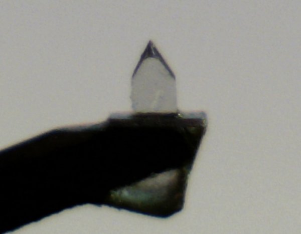

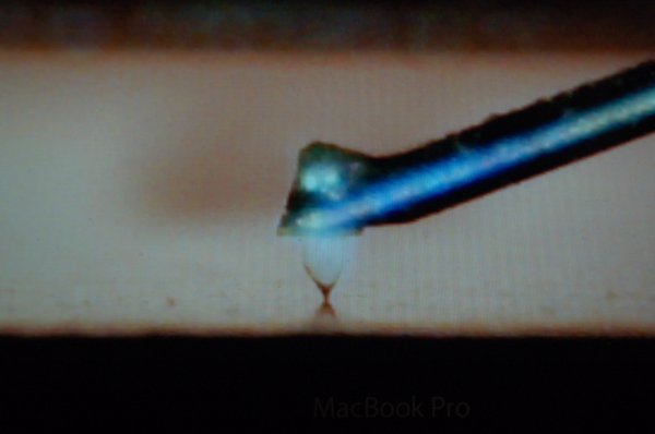

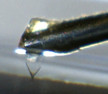

As a PC-1 Supreme owner, I find this thread fascinating and I hope that it helps answer the issues in the OP. First, I agree that shimming the cartridge is a bad idea. You want a clean, rigid, uncompromised coupling between the cartridge body and headshell. I agree with those who suggest raising the arm board instead is a more effective solution. But it should be raised uniformly, with a spacer, not by shimming the front or back up slightly.
I bought a USB Microscope for this purpose also, but I quickly found what the critics write. It is nearly impossible to align the lens with the stylus for an accurate reading. I now only use it to get nice images of tiny things uploaded to my computer. I will post some images of my Supreme stylus.
I agree with ddk that all final adjustments should be done by ear. I am one of those insane analog guys who adjust VTA/SRA for each LP. Once I find the setting I like, I record the value (height of my arm rest above the arm board) so that I can repeat it for the next time I play the LP. I set my SME arm parallel to the platter. I then use a 10X loupe to inspect the angle of the stylus shaft while it sits in the lead in groove. If it looks slightly past vertical from a loupe position that is "nearly" aligned square to the side of the cartridge, I know that the SRA is "just" beyond 90 degrees and in the ballpark of 92. I then listen and adjust by ear.
Remember, that with a 9" arm, each 1mm of arm height adjustments is roughly 1/4 degree of SRA, according to Fremer. So, every arm that I know of has at least 1 cm or 10 mm of height travel, meaning that SRA can be adjusted at least +/- 1.5 degrees. My SME arm has perhaps three times that adjustability as do most arms, meaning that with the arm parallel to the platter, you should be able to adjust SRA by 4.5 degrees or so. That is why seeing by eye that the stylus shaft is just past 90 degrees is enough to begin the process. There should be plenty of adjustability to get close to the ideal 91.5-92.5 SRA setting.
If your arm is not close to the middle of its range of height adjustment when it is parallel to the platter, the arm board itself needs to be adjusted where it meets the plinth.
I am comparing my Supreme now to my MSL Signature Gold cartridge. They have different stylus profiles and the latter is more sensitive to SRA. One other suggestion I have is that the Supreme has an ultra low internal impedance of 1 ohm yet it has an output of 4.5 or 5 mV. I have found that reducing the cartridge loading on my Pass SS phono from 100 to 1K ohms has improved the sound. The 100 ohm setting does make it sound lower in resolution and slightly duller/darker and less open.
Here are some photos without measurements which you can use to make rough angle comparisons:
