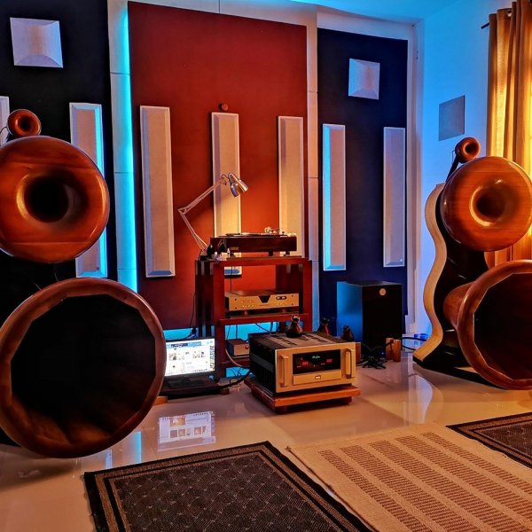

A bit of horn porn if you like JMLC mids - this is from the Sierra audio guys in my preferred mahogany:
I have heard his videos and don't find them better than uni or Anima videos. That said he changes drivers with each horn and also multi amps. Difficult to hear as he is in Philippines. The other two I know very well

One last comment because I am acutely aware this is meant to be a Uni thread. All woods sound different and quite dramatically so. If you wanted a very dynamic and hard hitting type presentation without plastic, maple is a great material. Unfortunately it isn’t easy to be able to know what different woods sounds like as a DIYer unless you have ability to make loads of samples and choose. Ebony would make a wonderful horn but cost the earth to do lol.
Each speaker is effectively bespoke so as you say any compare is impossible. The purpose of the post was to show a JMLC horn that won’t sound of plastic though rather than to claim anything about the overall horn.
I have heard across videos. I have to find an impressive one. They are good, just not liking them as much. I will take uni or Anima over them
