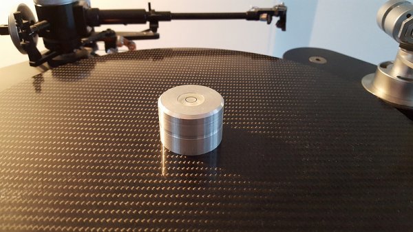

My leveling trick. Before I would use the built in level and a silver dollar size puck spirit level and place it by all three foot points to find level. Never seemed dead on. Today I removed the spindle and placed the puck level dead center. Easy peasy to get dead on level from the center spindle or get a slight tilt as Gary talks about. I can't believe I never thought about removing the spindle during the leveling process. Doh !!!
****I should mention for obvious reasons, the TT must be off or in standby mode (Platter not floating on air) before your can remove the spindle.

That makes sense, Christian. I use the same Ortofon level for my SME but place it just off center next to the spindle on the platter. Do you notice any difference when measuring at the center with spindle removed and slightly off center with spindle in place and the cushion of air under the platter? Does the weight of the Ortofon level off center effect the balance of the platter? Is that why you have to take the reading at the center and remove the spindle? I assume the platter is perfectly level with and without air supporting it and that the stylus contact pressure from VTF is not enough to effect the level of the platter when riding on the cushion of air.

My leveling trick. place spirit level over the spindle - pretty simple ;)

How does this Ortofon bubble level compare in accuracy to the Cartridge Man digital level?

On Amazon there is a comment that the ortofon bubble level is not very accurate. Who knows if that is true. I use a machinist level from starrett that has been calibrated. It is very sensitive to the slightest adjustment. The problem is that it is not a bubble level so you have to measure in at least an x and y axis.

Has one reliably heard differences between a platter that is level and one that is say 1 degree off? I wonder about this. I test my platter for level out of habit because my turntable sits on a Vibraplane, and over time it may need slight adjustment with fluctuations of temperature. The simple act of placing an LP on the platter many times will eventually require me to adjust the level of the Vibraplane. I wonder how much this really matters. I can't say I've heard any difference, but I have not done any rigorous testing to confirm.

Dan, I use two Starrett precision levels, too, because I never knew which was the most accurate bubble level to buy.

That's true Ron, you never know until you use a few different ones, they might even go off over time. Right now I'm using the AT level which I find very accurate compared to the one I was using for years and had gone off over time.
Good point Peter, I never tested 100% level vs slightly off either, it's just something we do as part of rigorous setup because it makes sense but I don't know the acceptable margin of error here.
