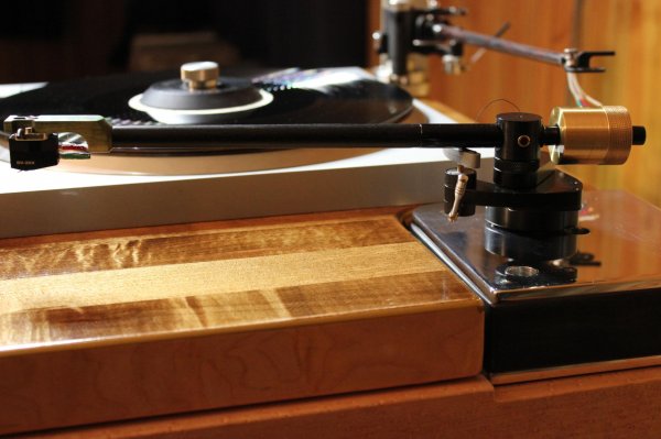

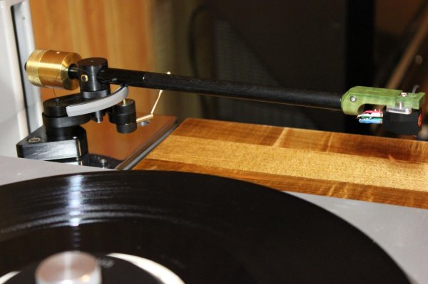

Schroder lT installed, pics a few comments...

So the Schroeder replaced the Reed?
jfrech
Sep 3, 2012
2,157
753
1,160
Austin
Audio Archer...CONGRATS !!! Looks great !!

Hi Sean,
Congratulations on getting the LT arm installed!
Did you get the silver wire version or the copper wire version?
(mine and John's are the silver wire).
Arnie
audioarcher
May 6, 2012
1,396
51
970
Seattle area
Hi Sean,
Arnie
Hi Arnie, I went with the silver wire option. It is incredibly thin gauge wire. It must have been a real pain for Steve to wire, but it sounds great.
JackD201
WBF Founding Member
12,319
1,429
1,820
Manila, Philippines
Makes me want to listen to my whole vinyl collection again to hear how it sounds through this arm.
The ultimate measure of success :D Congratulations Sean!
