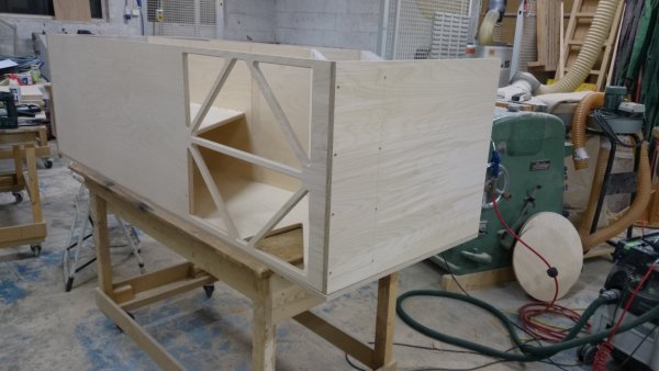

my sub horns are NOT TAPPED
they are purely 4 mfrontloaded with a pressurecontrolled/ventilated rear chamber...
Reactions: bonzo75
Sorry for the confusion, from the looks of it I mixed it up. Can you share a plan so I can look into what has been done there.
I think this was Sverre and Rune's idea, they had a paper on it that has been published on AES, I have it somewhere. It showed the dropping of the levels of distortion with this permeable back chamber but as far as I remember, it applied to frequencies over 100hz. I wish Rune could join and explain what he has done here. Can you make him do that :)
