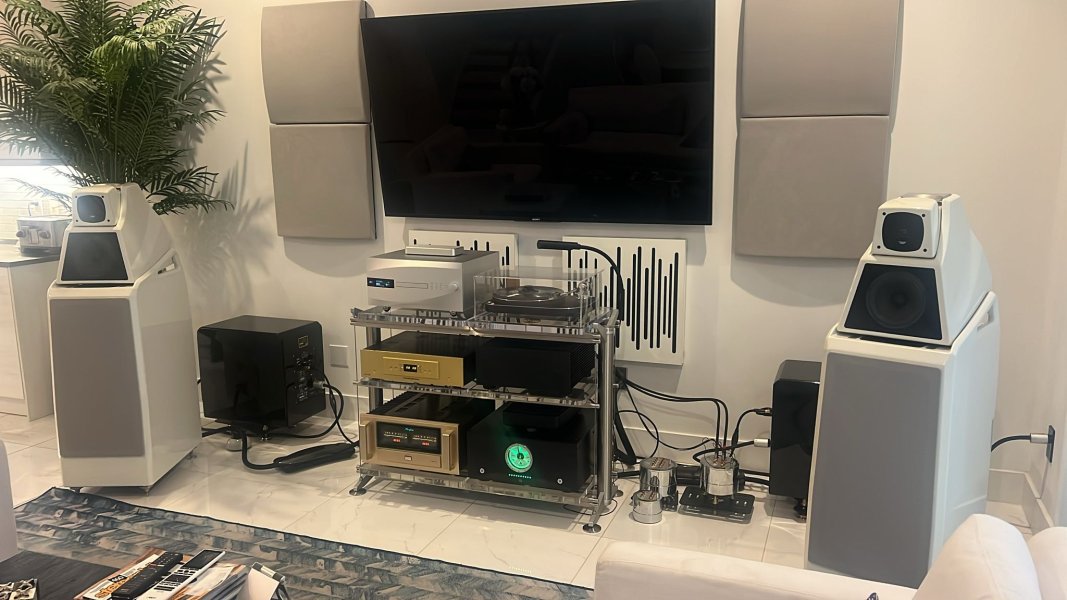

A while back I had the original Sasha, the original Alexia and the Alexia 2. My room is L-20', W-15' 7", H-7' 7", so slightly larger. The Alexias worked fine and I was told by Wilson that the Alex V would also work. If you have them set up by Wilson, or use their set-up method, the Alexia could work well for you.

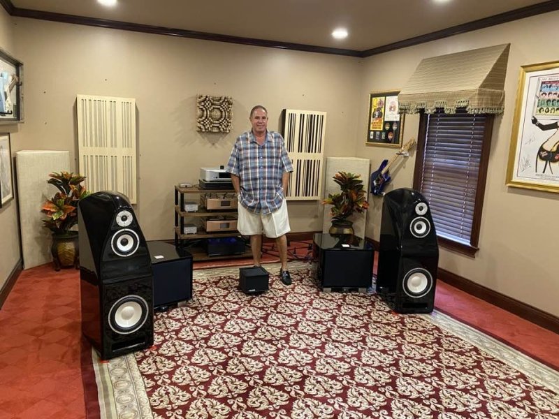

On Lee's recommendation I just purchased a set of Sasha Vs. They're still breaking in but I like them already, especially the setup. My dealer ended up with the Sashas 5 feet from the front wall, way more than Wilson typically recommends. In fact, thee dealer tried them closer to the front wall but the optimal spot was almost exactly where the Hansens were. That's the spot that Lee and renowned speaker setup guy Jim Smith found for the Hansens after many hours of experimentation. Lee's Alexia Vs are also further from the front wall than the typical Wilson install.
To my ears (and I know YMMV) when I heard them in a local store setup pretty close to the front wall I didn't think they imaged all that well. Maybe I'm wrong, but I don't understand how they can have very much depth 12 inches from the front wall. 5 feet from the wall in my room gives them plenty of depth.522369049_31607982208801119_8141398425744906042_n.jpg

Beautiful room! How big is your room, and is the 5 feet measured from the baffle or from back of the speaker? Are you sitting in an equilateral triangle ? Regards.
Thank you. The room is 16x21x9. I wish the ceiling was higher but that's basements unless you build from scratch. It took 2+ years to find a house that worked for us. I know the guitars on the wall and the framed memorabilia is not optimal for sound but I wanted a room I enjoyed sitting in.

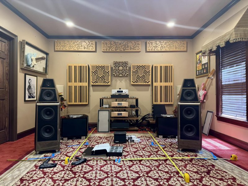

I just measured the setup. The speakers are 88" from the front wall and I sit about 100" away from them. A great deal of time, probably 12+ hrs was spent on setting up my original speakers (Hansen Prince) to minimize room modes. Jim Smith is an expert at that. My Wilson dealer, Ember Audio of Winston-Salem, NC started out with the standard Wilson set up where the speakers were much further away from me and closer to the front wall (standard Wilson). He kept moving them in a precise grid until they locked in. The final position is within 3" of where the Hansens were. They image much better than when I demo'd them. They were probably 18" from the front wall and much further apart. That was a much better room than mine but I felt there wasn't much depth. Everyone's tastes are a little different but this works for me.

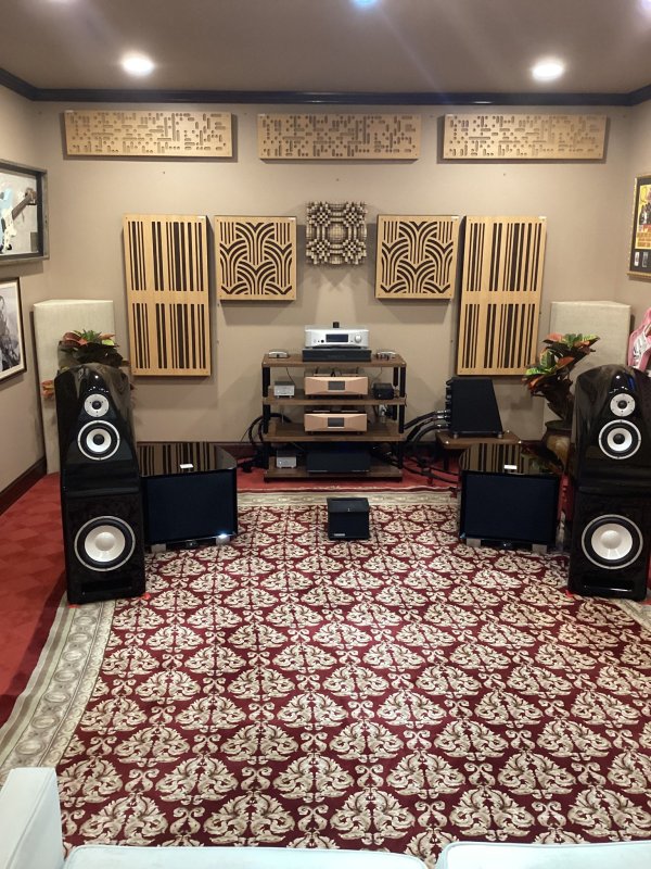

A couple of more (earlier) pictures of the room with the Hansens.519626871_10235952591622544_6210110328527539650_n.jpg449599636_10231054824141418_2763736252805203325_n.jpg

A couple of more (earlier) pictures of the room with the Hansens.View attachment 155685View attachment 155686
Thanks for sharing the details and the photos! Congrats again on a beautiful setup. I bet it sounds sublime. Regards.
