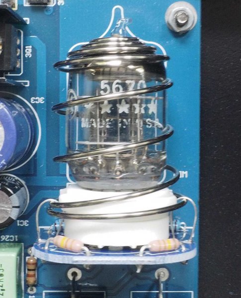

Hey folks. New to the forum but not to tubes, having been associated with a few high-end audio manufacturers specializing in tube gear back in the day, but for the life of me I can't figure out what this is or is called:
Came installed on the tube in a DAC I bought. I imagine it's some sort of tube "holder" but what's it's purpose & does it really do anything outside of making it a little less convenient to tube roll? Is it supposed to "dampen" the tube?

only way to know is to play music with the damper off and then play same music with it on
Reactions: Albertporter
Herbies Ultrasonic dampers can have an audible benefit when used on components with exposed tubes. These tubes can be subjected to acoustic vibration. The dampers can tighten the bass and increase focus. Tubes that are slightly microphonic can benefit from tube dampers.
I've found that tubes enclosed in the component may or may not benefit from damping. ARC uses tube dampers, while my Audio Note components perform better without.
