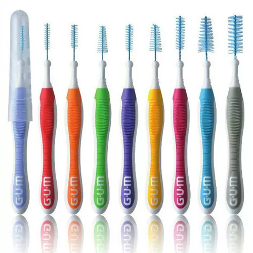

theese are good for tube sockets and female panel connectors
Great idea for a lot of cleaning needs but … it may be too aggressive for tube sockets. They tend to lose their springiness/grip with repeated insertions.
I hope you pay attention that they don't go too deep into the female connectors. I always use pipe cleaners but make sure that I restrain depth of insertion, holding them "on a leash" with my fingers as it were. You don't want to accidentally damage the electronics inside your gear.
