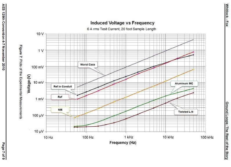

IMHO it is not too complicated unless you use too thick wire or very long runs, although the electrician found that I was crazy! For those not knowing one of the critical points is closely twisting neutral and live separately from the earth wire - something I could not find in commercial wires. See the figure from the paper: (lowest induced voltage means less noise)

Yes, twist the hot/neutral with a drill then wrap the ground wire around the twisted pair in the opposite direction so the ground crosses the other wires at an angle. Or just leave the ground separate, it's not quite as nice but better than having it run parallel to the other wires.

On power line twisting. Another froum had part of a thread on twisting cables. Some frowned on using drills. Something about it would untwist the individual conductors. In any case only 3 twists per foot (1 twist per 10cm) are needed for electrical reasons. But more may be added for mechanical purposes (like keeping it together). For the Safety Ground/Protective Earth a lazy spiral in the opposite direction might be good. Or just tape the SG/PE to the twisted pair.
