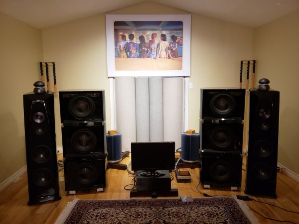

Hey, Kerry. How are the new speakers burning in? I see there's already some pretty good responses to your OP but I'd like share some random thoughts on bass.
I envy your having the stacks of REL G1's. But at the same time, I can see potential for much frustration, especially with the new Bayz. It can be difficult enough dialing in a single subwoofer for superior performance - much less 6 subwoofers. In my case, I gave up years ago striving to achieve a musical bass from my mains in my new shoebox dimensioned room. I eventually bought a 15-inch sub and after much playing around (not sure I really know what I'm doing) I was only able to muster a me-too bass response with the sub taking things maybe 6Hz further south. Eventually I went back to the sub's user guide / summary sheet and really tried to read between the lines and after about 10 more adjustments, I got it. My sub is a Rythmik and luckily it seems to have enough toggle switches and knobs that I never once moved my sub since installing it 5 years ago and still achieved a musical bass.
From my somewhat naive perspective, achieving truly musical bass is as much a crapshoot as it is art and science. But boy is it worth it if / when the planets are in alignment. Then again, it's even more of a crapshoot when trying to achieve this musical bass with a pair of full-range speakers without a sub since there's usually few if any knobs and switches to tweak the mains hence, optimal placement means everything and that can be the most frustrating thing to find.
I'm curious. How are you currently tuning your subs? For example. Your subs come in different paired heights from the floor. Are you adjusting all subs all the same time with a single click of the remote or are you shutting down the majority of subs and adjusting 1 or a pair at a time? Or are they daisy chained so you have one or 2 masters with the remaining subs hardwired as slaves, if that's even an option with the REL's?
It seems from my perspective anyway, that your fine-tuning options are limited with the REL's. Does it seem that way to you? If so, then I suspect like with full-range speakers only, optimal sub placement must be paramount.
Do you know for a fact that the musical bass you're striving to achieve even exists on the recordings you're playing? I ask because not every recording will generate this musical bass. Sure if the bass is really dialed in via the mains and subs, etc, all bass will sound more musical than previously. But not every recording was engineered to capture / reproduce a vigorous tight, deep, pronounced, well-defined, and otherwise musical bass.
A few notes about musical bass:
1. The bass region is much like the playback system as a whole. Implying there's mainstream bass and then there's truly musical bass. Just like there's mainstream high-end audio and then there's truly musical high-end audio.
2. Like other parts of high-end audio, it's difficult to tell from just reading who's capturing truly musical bass. Based on some of Mike Lavigne's responses and hardware and professional consultants, I certainly get the impression he's there to at least a good degree.
3. IME, musical bass is even more elusive than achieving a musical playback system in general. But it also can be the most rewarding and exhilarating part of a playback prresentation when/if achieved no matter what you think you've accomplished elsewhere. The point being, since musical bass is potentially so elusive, it can be rather difficult to discern who is coming from what perspective when responding to your questions.
4. Just like with a mainstream high-end audio system missing so much music information, a bass region lacking this musical bass is also making so much of the bass inaudible. And it's not just a little bit missing. But when achieved so many more bass notes are "discovered" and audible. IOW, lacking a musical bass is worse than we think.
5. When achieved, there's nothing as exhilarating as listening to truly musical bass as it appears to be the foundation of the music presentation. But there's so much more than just musical bass. When this level of bass is achieved, it almost magically balances out the entire presentation, giving weight, warmth, tonality, depth, and width and height to so many other instruments as well as the presentation as a whole. Playback presentations that previously sounded a bit light or even shrill are gone as we're now hearing more warmth, tonality, and bass throughout the entire playback presentation.
A few other thoughts:
1. Regarding the wave launch thing you mentioned. Are you really just thinking about lining up drivers in unison so they're best aligned / sync'ed for the initial attack of a bass note? If so, I suspect that's probably the end game.
2. My experience with subwoofers is limited but I like to think I know what fabulously music bass sounds like. In fact, what I have right now is the 2nd best I've ever heard and pretty close to the best I've heard. The best I've heard came from a pair of full-range speakers with 11-inch woofers easily able to go down to about 23Hz and no subwoofer. Since I had already given up trying to get this musical bass in my newer room and newer speakers and after buying a subwoofer to augment didn't add much, frankly I'm still surprised I was finally able to achieve this type of musical bass from a single 15-inch sub. Perhaps it's a tribute to Rythmik's designer, their servo drivers, their many dials and switches, etc. Aside from this sub I've no other experience with Rythmik but they seem to get some pretty good feedback on their products. And for a while there, I was unimpressed enough to put my Rythmik up for sale - until I finally dialed it in. But I also realize that my sub could benefit from 2nd matching sub, or better yet an 18-inch pair of subs to achieve lower Hertz while perhaps benefit from greater power.
3. When going from so-so bass to musical bass, I've never once moved my sub since initial install 5 years ago. Perhaps by luck of the draw I originally placed the sub in a sufficiently optimal location. Then again, what's that probability? If the REL has few tuning config options/settings, then perhaps placement becomes more paramount - much like full-range mains???
4. The Duke mentioned above some good thought-provoking points. But he also suggested placing subs in the corner. He may be right but in my rather limited experience with subs, I've yet to hear any subwoofer sound anything even remotely close to musical when placed in a corner. Not saying it can't be done and since subwoofer tuning can be quite a crapshoot for some of us (me) more naive types, perhaps it can be done. Still, of those systems I've heard with subs in corners, it's only been a dismal overloaded boomy and rather ill-defined bass.
5. I suggest never underestimating the role of significant distortions induced elsewhere in the playback system. I would never say that remedying those distortions induced elsewhere in the system are a substitute for a superior-positioned pair of full-range speakers and/or a superior-tuned and placed sub. But I can say that addressing significant distortions elsewhere in the system can greatly enhance whatever type of bass one is currently getting.
6. In my current config, I'm unable to utilize the high-level inputs to my sub. But in theory anyway, I still have several reasons to question REL's (and others) take that high-level inputs are the best sonic option.
7. If per chance you're restarting from square one, maybe it would be best to remove all subs from the room but one. Configure and tune that one sub until you've achieve a truly musical bass, then install that sub's twin (2nd sub) in the exact opposite location with exact same configs. Then advance to level 2 subs, then level 3 subs.
8. I don't know if the REL's will allow but a superior cone/spike/point footer allowing the subs to settle into the sub-flooring is of real sonic benefit just as it is with speakers and components since the same principles apply regardless of object.
9. The topic of achieving a truly musical bass isn't really discussed much. This leads me to think either most have already achieved it or few even know it exists. I know where I'm putting my money here.
Sorry to be all over the bass map here but I suppose what I'm really trying to say is that in the end every sub, speaker, system config, and room combo is unique and special and different and hence, every suggestion has to be taken with a grain of salt. IOW, there's no substitution for spending time working with one's own system in their own room, right?

I love my 6x12" Rel Gibraltars, which, when fine tuned over many many hours together with my previous Rockport Cygnus mains (which by themselves were -3db to 20Hz in room), added not only 5hz extension, but much, much more to the presentation than one might think.
I have tuned the system to be flat, with no boom or location information relative to the sub towers. Yet its very easy to hear the subs contribution on the bottom 2 octaves of most recordings (say below 100 hz).
People who believe that careful and systematic extension of the mains, even those mains that are good to 20hz, is meaningless or of little benefit, without actually experiencing or hearing this, are simply deluding themselves IMHO.
FYI, the subs are low passed at 20Hz for the bottom pair, 22Hz for the Middle pair and 24Hz for the top pair.

I love my 6x12" Rel Gibraltars, which, when fine tuned over many many hours together with my previous Rockport Cygnus mains (which by themselves were -3db to 20Hz in room), added not only 5hz extension, but much, much more to the presentation than one might think. View attachment 64049
Do you have an opinion on how the six G-1s with 12" drivers and Class AB amps compare to, say, four No. 25s with 15" drivers and Class D amps?

I have not heard the G25's in other than show conditions, so I can't comment directly. But I'd be surprised if the result wouldn't be similar. I would expect it's just trickier to integrate 4x15s vs 6x12's, especially with the hand off to the 8" woofer towers of your Pendragons. As for class D amplification, if it's done well, I see no reason to avoid this implementation, class D amplification, to my ear is as good as A/B or A for below 100Hz response.

Stellar work!..and this is an example i remember seeing where you had truly gone to great lengths to go where my email to Duke Lejeune was asking for expert opinions and guidance. Thanks for posting this.
It would be great if you could describe a bit more about what exactly you experience when you say the well set up sub towers add 'much more to the presentation than one might think"
Thanks for posting!
