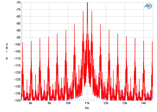

Sadly few companies publish such data. One of them that does is Audiophilleo. And for Halide, we have measurements performed in stereophile review. Here is a comparison of using Toslink out of a pro audio card, RME, on the PC running an external DAC relative to Halide. First the Toslink:
Ideally we would have just that center 11 Khz tone there and nothing else. The extra pulses are created by high levels of jitter despite the device producing it being a pro sound card with its drivers, buffering and such.

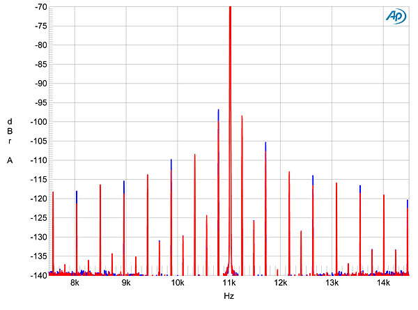

Now the Halide driving the same DAC using async USB:
As you see, the level and number of jitter sidebands is heavily reduced and now well below the CD's 16-bit noise floor. With better DACs than this cheap one, it still makes a difference and produces extremely clean output. I believe this is a good representative of other async adapters since this is one of the lower cost units.
So the evidence does point to improvements there and in a compelling way.
