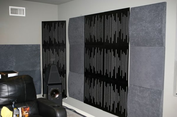

Panels installed
Still haven't finished the ceiling, waiting for next shipment.
