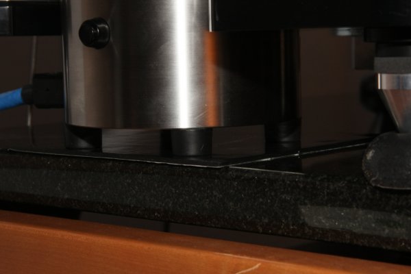

My Zoethecus rack is not big enough to fit a Bright Star Audio sandbox, so I launched on my custom vibration isolation solution, comprised of Stillpoints and Sorbothane - remarkable and easily verifiable results with simple knuckle tapping and obviously listening:
1) Stillpoints with Hard Coat Mini Inverse Risers isolate the granite shelf from the rack - estimated reduction of -20dB
2) Sorbothane Hemispheres are used under the VPI's feet - the feet literally sink into the Sorbothane mass; 'table is still extremely stable; estimated further reduction of another -20dB
3) Sorbothane sheet sits underneath the motor for further isolation - whereas before you could feel the motor vibrations by simply touching it, they are now virtually gone and absorbed by the Sorbothane
Every incremental step was tested by playing a silent track on a test LP, and every step offered measurable improvement; I cannot stress enough the effect of the sheet under the motor.
I also had an HRS S1 isolation platform in for eval, which came close to these results, but still lags. The results are expectedly significant, but I think a sandbox approach plus the Sorbothane sheet would have been even more effective.
