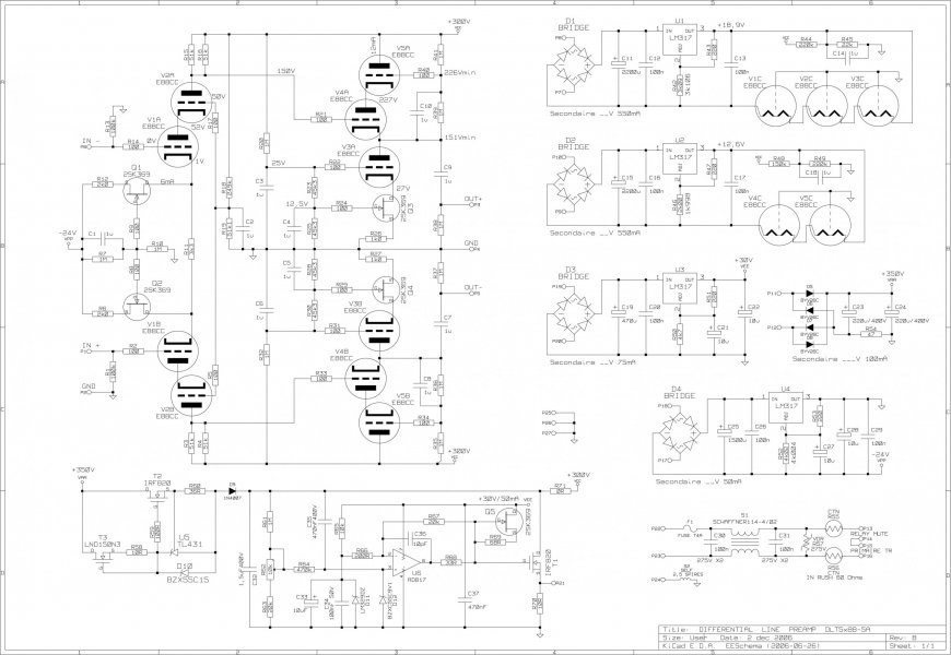

I think there may be more than one version, but this should be close for the line stage. I don't think the phono stage changed from the RTP3C.
Don't forget the tube heating or you get a Ufk problem with the circuit. The voltage difference between the cathode and the tube heater (DC) should not exceed 100volts(ecc88)Tube v4-v5. The only thing that helps is to increase the DC heating voltage. All you need is two resistors (2watt type) and a 10uf electrolytic capacitor. If you don't pay attention, you'll have to change the tubes very quickly - frustration is inevitable.

This is the same schematic that I posted, which I believe is the RTP3D. The RTP3C schematic was available on the Vacuum State website for a long time (although doesn't appear to be working now) and is a bit different. The main differences are: The RTP3C uses a single current source for the input stage and uses a negative bias supply for the cathode follower stage CCS. I've included it below.
The schematic I posted comes from the instruction manual to build the "beta test" version of the RTP-3C. There were 10 of us building this prototype. There were further changes, but minor, after the prototypes were built.
