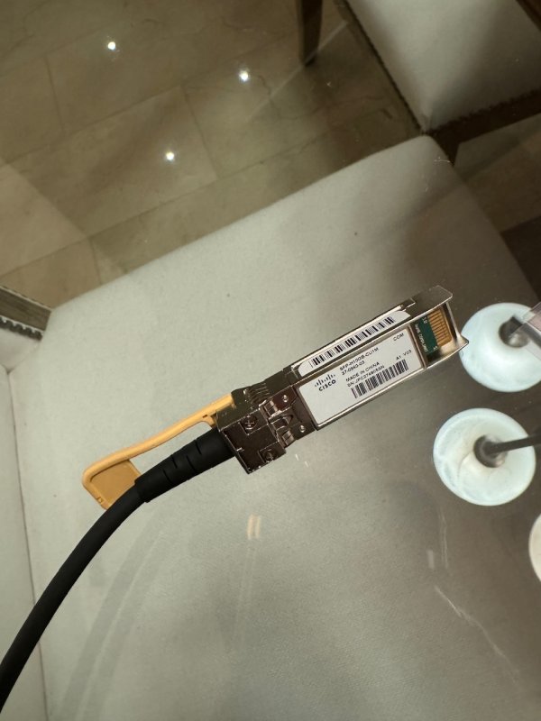

Received my Teradak TS212 and also quite recently got in the Cisco 2960G switch along with a Cisco fibre optic cable

I set about hooking up the Teradak converter. Unfortunately I am not getting any ethernet signal confmation on the streamer (EverSolo DMzP-A6 Master Edition). The indicator light on the fiber port is not on so I assume nothing is coming through to the switch?
The config is as follows: Spectrum modem router via ethernet cable is connected into the TS212. The fibre cable is connected to the fiber port. The fibre cable is about 1meter and connects into the 2960G fiber port. I tried the ethernet cable that connects from the 2960G into the DMP-A6, plugged either into the port next to the fiber port and then also into one of the other open ports (not console). No joy. Any guidance greatly appreciated.

Well the cable you bought (Cisco SFP-10G-CU1M) is not even fiber optic. That’s a Direct Attach Cable—which is dual twinaxial copper terminated to an almost empty PCB inside the SFP shell. They have their uses but provide zero galvanic isolation.Hi Superdad! Thanks for responding. Please find photos attached. It is an actual Cisco cable. Hopefully I got the right one with compatible transceivers?
