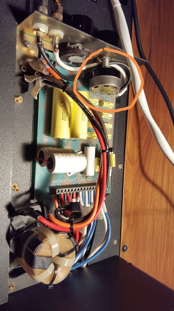

Hi Gary
This is my first post here, i have just acquired a pair of Genesis g2, it seems potentiometer on the one of the mid and hi tower crossover is not working. I just wondering if you know the replacement parts number for this.
Please refer to the attached photo as circled.
Sorry I borrowed Mak's photo posted here.
Many thanks in advance for your time.

Hi Vincent,
I can see if I have a picture of the cables while being made. If you have no experience with schematics and electronics you might be better served having someone make a set. Pretty easy with the parts listed and soldering. It does make a big difference in the timing and output of the music after comparing the 2 set ups. The cables are wrapped with shrink tubing and I do not want to cut it open to show what was done.
I suggest you go to Audio science review and ask others there to help provide the information you want. I only come to this site because of the Genesis forum.
If I made another set I would use a small piece of breadboard to hold the wires and resisters in place.
The G2 bass columns are difficult to blend with the panels and I suggest you learn how to use REW with the Umik1 to measure the room response, correct phase and other aspects of reproduction. The biggest impact you will get after your purchase will be the room itself and DSP. Look into Audiolense or Accourate for making filters. If that does not appeal to you, contact Mitch Barnett.
I may have a couple of the potentiometers in a box somewhere. They are marked with the value on the body if not mistaken and manufacture.

Hi Vincent, looks like you already got a few responses. I was busy at the Capital Audiofest, and this week visiting dealers, customers and partners.
The potentiometer would be a 1 ohm wire-wound pot. Not sure of the part number as the G-II was built nearly 30 years ago. Even if I knew the part number, it would likely be obsolete. Any 5W 1ohm wire-wound pot would be a substitute.

Here is a picture of the replacement pots I bought off of Ebay. They are not the correct value, but the same as ones I soldered on the board.
I wanted to keep the original parts and fitment to the PCB board so there were no modifications. Remove the back cover and take a picture of the stamping to see the value on your pot. I cannot find the pictures from the rebuild, but you now know they are Violet pots. You should be able to figure it out from there.

That is great, it is look same as the one in my crossover, I couldn't found out my because my one is a bit rusty and can not see which model. My speaker is made on 1996, by opening the crossover, it is look slightly different from your crossover photo posted here. I will order the pot today if I can.

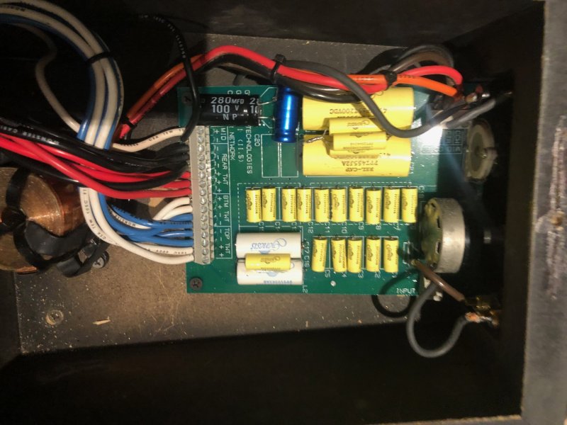

Hello!
I have a question for knowledgeable people
Could you please tell me where on the photo are the bipolar electrolytes photo 1 and whether they sell separately the film membranes for the tweeter photo 2
Excuse my far from perfect english
Regards
Lex

Hello!
Regards
Lex
The blue and the black ones are bipolar electrolytic capacitors. The yellow and white "Genesis" branded ones are film.
The new tweeter is sold as a complete unit. We have never sold the diaphragms. I understand that the old company used to sell the diaphragms to repair centers.

Hello!
Thank you very much for the answer
I bought the G2 recently and how do you think i have the original bipolar electrolytic capacitors or not ?

Hello!
They look original. Hence, after 25 years, it might be beneficial to change them. But there is danger.
Many of the older speakers have had the original midrange ribbons replaced with ribbons purchased off the Internet. These B&G 48-inch ribbons for the DIY market (and their own speakers) are designed to be used from 250Hz to16kHz. The Genesis II (with the Carver ribbon) and newer Genesis with the OEM Genesis ribbons by B&G are designed for 150Hz up.
As capacitors age, their capacitance goes down. Since these electrolytic capacitors are in the high-pass of midrange crossover, as they age, the high pass goes up from the original specification of 150Hz. With older capacitors, the crossover works with these ribbons.
Hence the danger here. If you change the capacitors to what they should be, lower frequencies will be sent to the midrange ribbon. If they are the DIY B&G midranges, or the midranges have aged and weakened, sending lower frequencies to them may cause them to fail.
