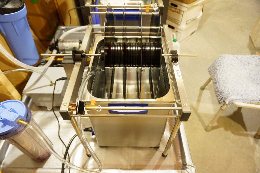

I bought the 3ml Calibrated Eye Dropper pipettes Neil mentions, and 1 pint of Tergitol 15-S-9 from Talasonline.com ($21.75 + ship) The calibrated pipettes graduated in 1,2 and 3 ml are a perfect tool for adding Tergitol to a tank - very nice, thanks for the suggestion Neil. I emptied the tank of its water+ILFOTOL solution along with the filter cannister. Filled tank and cannister with fresh distilled water then degassed the tank for 20 minutes. Then I added 2ml of Tergitol 15-S-9 to the tank and ran the pump. I can report that 2ml Tergitol in the 12.75 liter tank yields a small amount of foarm, nowhere near as much as the ILFOTOL I had been using (albeit with good result.) Fwiw, 1ml of Tergitol 15-S-9 showed no foam. Now I'll clean 4 records with three RD spacers between. Results later.
part 1: First cleaning with Tergitol 15-S-9 ...
Add ~ 2ml of Tergitol 15-S-9 to ~12.75 Liters of distilled water:

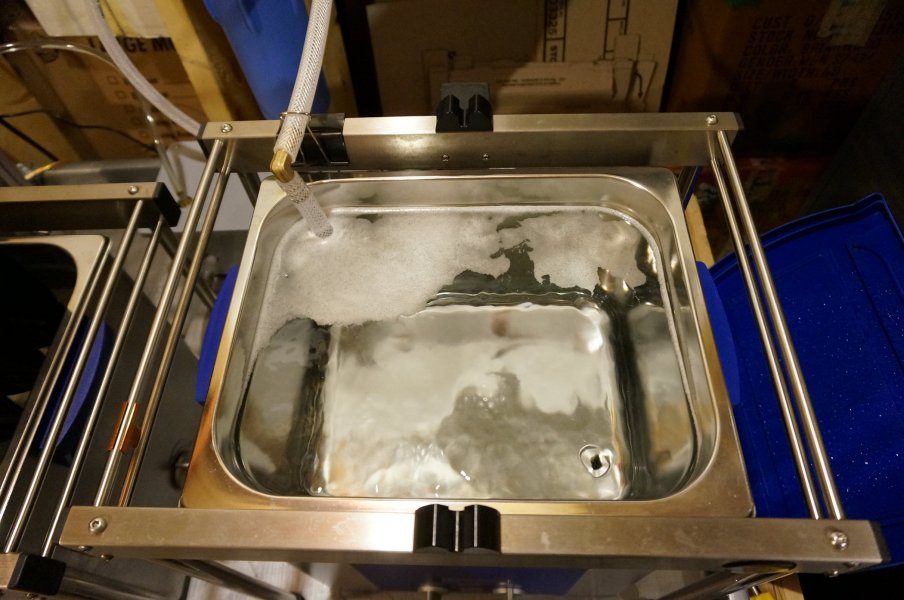

I don't have a comparable picture using ILFOTOL, but it presented a greater amount of 'air' in the foam that caused it to billow more above the surface.

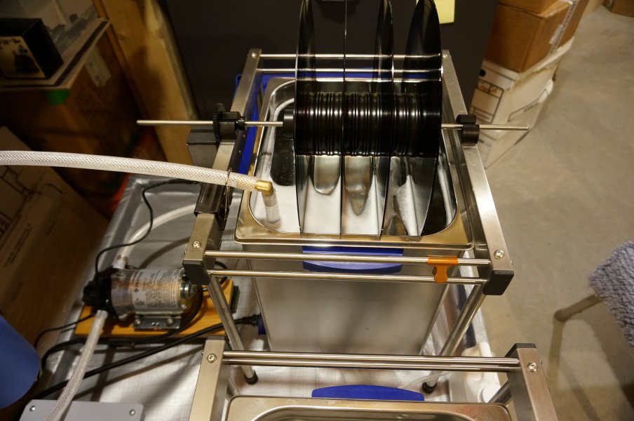

part 2: First cleaning with Tergitol 15-S-9 ...
This photo was taken about 3/4 of the way through a 20 minute wash cycle. 10 min at 37kHz, 10 min at 80kHz. The foam dispersed as shown. It confined itself to the left half of the records where the filter outflow resides. Based on Neil's information I speculate the 2 ml of Tergitol S-15-9 should get beyond the CMC (critical micelle concentration) achieved by the amount of ILFOTOL I had been using to yield a greater detergent function. Iow, beyond lowering surface tension, more soap is available for cleaning. I also speculate that an equivalent amount of ILFOTOL would result in way too much foam, even going over the edge of the tank.
One minor note: when I used the ILFOTOL I originally had the filter outflow tubing just above the water's surface. I speculate this contributed to increased foaming. I change the downward pointing tube to reach about 2/3 of the way into the tank. The agitation from the filter return probably contributes to foaming.
Into the rinse tank for 10 minutes at 37 kHz ...
Whatever foam (if any) was carried over on the records disbursed quickly ...
