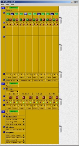

I still do... the DAD AX24. I don't recall it having it's own dither, but instead using the dither of the software Pyramix that it was attached to. I don't see an option for dither.
Excellent that is what I thought; this makes sense because I thought dither was moved sometime ago from being an external source input with/within ADC, to now as you say within the modern studio DAW itself after the ADC.
