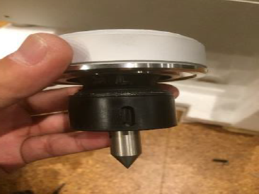

Anyway, after moping around for a couple of days, I decided to installed the 'S' rubber feet to bring the AF3P to AF3P'S' spec. These feet with integral very compliant rubber compound is a revelation. Vibration to the chassis of the TT is very much reduced. No more hum from the PP2000 cart. However, the TT motor & power supply unit / pump still vibrate. Chasing my dealer ...

I have the 3P and the 5P, both pumps does vibrate very faintly and if you put the pump and the TT on the same rack, a very slight faint low frequency can be picked up by the TT.
I am also considering the S upgrade for my 3P, from my understanding, similar feet design has been used on the 5P. How did you find them and how much you paid for the upgrade?
Reactions: joeling
The S upgrade makes a huge difference in terms of vibration damping. As mentioned either in this thread or another that my Phasemation PP2000 was picking up vibration from the motor & translating to noise at the speakers. With the S feet installed, the noise was no longer audible. Very expensive for 4 rubber feet though. Could have been nearly USD2k.
price in Germany is around 2500,- eur incl VAT.
to my knowledge, this is not rubber, but a GEL filling in a dedicated frequency range.
The feets do have a Delrin part as well.
This feels will fit the former AF3 as well.
