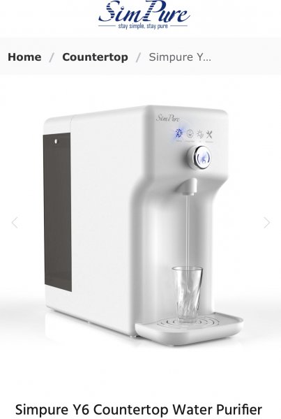

It turns out that in the ensuing 10 years several companies have come up with completely self-contained, table-top, AC-powered reverse osmosis water filter machines.
We just received our SimPure Y6 RO/UV water filter machine. Although made in China, it looks like a pretty nice and well-made machine. And it seems to work quite well!
Several other table-top RO machines look more sophisticated and achieve better spec'ed RO filtration, but Tinka wanted a water filter which has a UV filter to kill any viruses in the water. This device claims to have that function.
Does anyone have any experience with table-top RO water filter machines?

UV is not a cure all and in fact there is no way would use it to clean contaminated pottible water. yes under certain conditions it stops reproduction of certain given bac and viral and parasites. But each needs it’s own exposure and intensity.
We are told to boil water to kill only and it does not remove chemicals if water supply is contaminated.

UV is a sterilization technique, not purification. It interrupts RnA + DNA so cells are unable to reproduce, you still get to drink the little bug bodies. The RNA + DNA are often what causes the bodies inflammatory immune response (pyrotoxins). Better to remove any bacteria, cyst, or virus. Reverse osmosis alone in not considered a failsafe and why all such systems come with EPA mandated disclaimer “must be used on microbiologically safe water or with adequate pre- or -post disinfection.” (e.g. UV light)
Our systems all include .2 micron absolute filtration to ensure 99.999% bacteria, cyst, and virus removal, nad why we are exempt from above mandated disclaimer.
