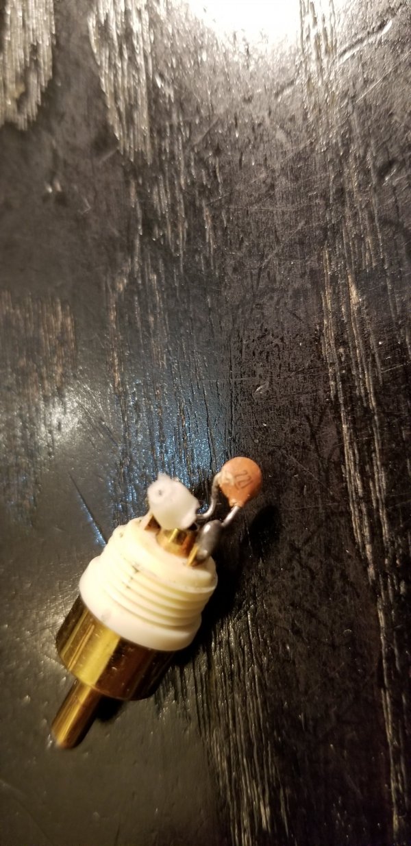

Anyone has experience of the structure of the 3012 tonearm cable, due to suspicion of broken wire issue, I have to disassemble the cable completely to see what happen, surprisingly I found out there is a small carbon resistor (or capacitor) hidden inside the plug on one end with a label 221 printed, if this is the case for all other 3012 type of cable that means the pre-loading of the resistance value is inevitably avoid.
Very interesting...
Got any photos?

If this applies to all former SME cable (i doubt) which could possibly mean the capacitance is pre loading to the cartridge, in my experience some phono stage design the starting point is 100pf while some others were close to 0pf, higher the figures which could tame the treble.
There were some SME cables that came with those capacitors fitted as standard, particularly those supplied with the 3009 Series III and 3009 Series II Improved with the fixed head shell as those arms were very often used with the Shure V15iii and that cartridge needed the extra capacitance. Indeed I believe the 3009 Series III was designed with that cartridge in mind. What the provenance of your cable is I have absolutely no idea but I can think of no other reason why it would have come with those capacitors fitted. If you search the web you will find lots of posts where people have complained that the 3009 Series III doesn't sound good only to find the capacitors, remove them and be astonished at how good it is with the right cartridge.
