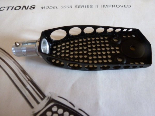

As far as I could see we can have a fixed SME 3012R - SME has an headshell with a coupler that replaces the connector, similar to this one used in the SME 3009 series II. We just take the connector and wires out of the arm wand and replace with the integral headshell, also replacing the wires with longer ones. Unfortunately (or perhaps fortunately, it would take a lot of time and I would loose the convenience of easy change) I only once saw one for the "R"models in eBay.uk and lost the auction! The shown headshell is not compatible with the "R" version.
Uhhhh, do I not see a junction between the headshell and the arm in your photo????
