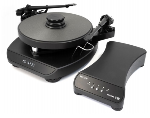

It isn't on the SME website yet, but you'll find it listed with some UK dealers: a version of the Model 12 with room for two tonearms:
