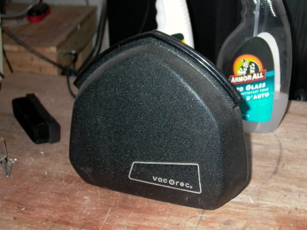

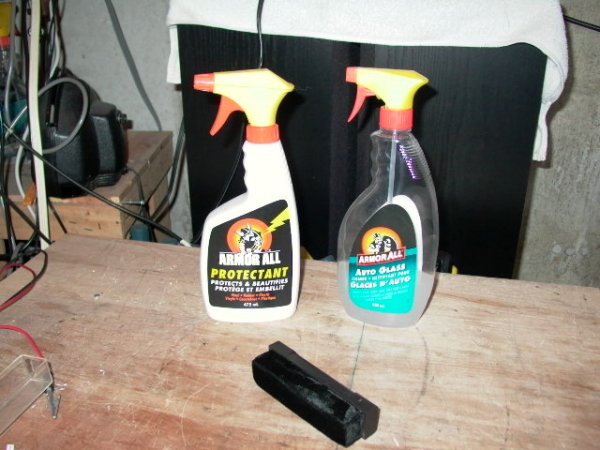

brand name made machine will cost too much $ , I did one with little money, a old SONY player only $20, pad brush attach to the tonearm, compressed air pump for clean up surface's solution, that is it, Armor All car wax is silicon base, too thick for use, I mixed 4 to 5 drops to a half bottle of Armor All car glass cleaner after clean the record do it again with this mixed solution, but no blow out this time, use paper towel to clean the most, white wax will remain on surface, another fresh paper towel for polish, I use a record vacuum cleaner for more polish, silicon has less friction to needle, that make sound more smooth and sweet, on the top less dust and static, if you not sure safe for your vinyl try one you don't care much and you will find the different, I been doing this to my vinyls for more than 8 years, so far nothing in negative

reason of it looks dirty, first I use blow away not sucking, unit mess with liquid , and I am too lazy not to clean up every time after useed, ( a lazy diyer only look for how it work not how it look ), maybe those dirty is from the dirty vinyl. second I started the project around 8 years ago, but I join forum just from last year and took pictures, the unit has not been used for a long time, one coat can last quite long do not need do it often no new vinyls too in 2 or 3 years

I did try many different coatings, in the beginning wax was too thick, then stylus stacked with wax, till I got the right thinness one since then no more problems, Last week John asked me why I place a mirror under the cart when he came over, answer is to check with stylus in a easy way but after the right coating I have not use the brush to clean the stylus not even one time, How long can the coating last ? you can judge by listening, flesh coating can sound different, fun to have a try won't cause too much money of it
