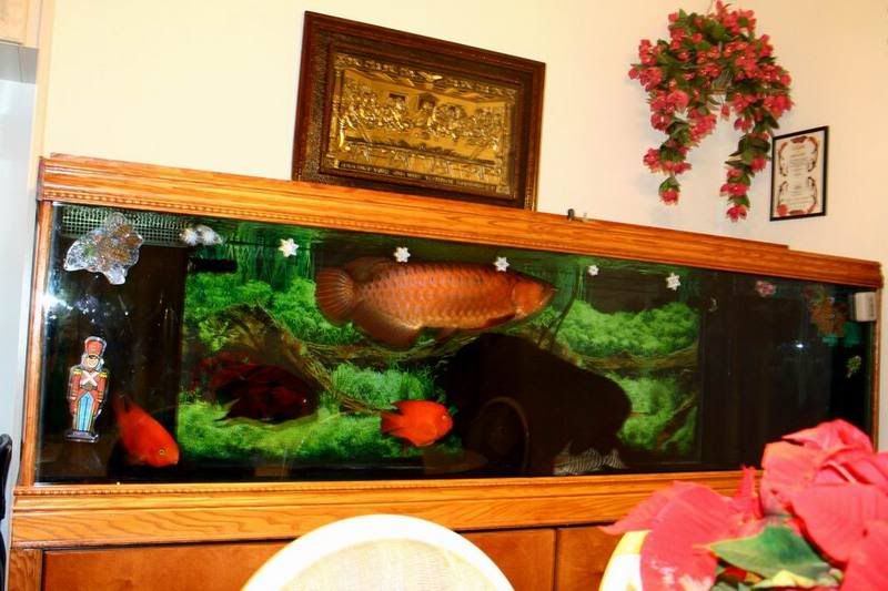

this is the picture of my 210 gal setup with 70 gal sump underneath. The overflow chambers are in the back corners. I would once in a while leave a feeder fish inside these chambers to eat food that gets trapped in there.
I had a mature asian arowana (26"), a full grown tigrinus (15") a mature male motoro stingray (14" dia) 2 bloodparrots bigger than my hands and an 8" flowerhorn and a mature green severum here at one point. I had to wakeup some nights to wipe the floor when they decide to rumble.
