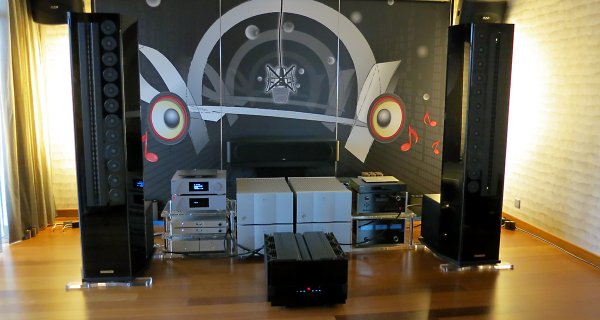

Nice setup.
When you switch out amps with different gain, how do you adjust the powered woofer's level?

Nice setup.

Thank you.
The Genesis speakers have one set of binding posts, so that the included amp gets the same signal as the passive crossover. That way, switching amps does not require adjustment of the speaker. Nevertheless, some adjustment is needed when high output impedance amps are used. Hence, I do provide for this with user adjustable gain and low-pass frequency.
