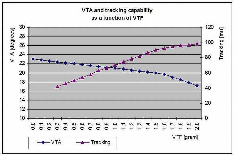

Hi,
as VTA varies with VTF, I wonder at what VTF you play your Classic GE Mk II?
(VTF up means VTA down)
Best regards, Tony

Hi,
Best regards, Tony
I have set the VTF at the recommended 4 grams. The bottom base of the SPU is set so that it is parallel to the record surface. Of course this changes in tandem with the record thickness.
The SPU is new to me so for now I am just listening. The GrooveMaster arm does not allow for adjusting VTA on the fly. Even if it did I would not likely use this feature. My methodology has always been to find the settings that make the majority of my records sound their best, set it and just enjoy the music.
For clarification, what do you mean when you say VTA down? Bearing end of cartridge down I would think.

Regular VTA is about 20°, raising VTF might result in a reduction of VTA, like going down to about 16°.
A too low VTF might couse for VTA to be too high, like in the range of 24°.
With an optimum arround 1.5 gram obviously not a SPU ...
Reactions: AudioHR
