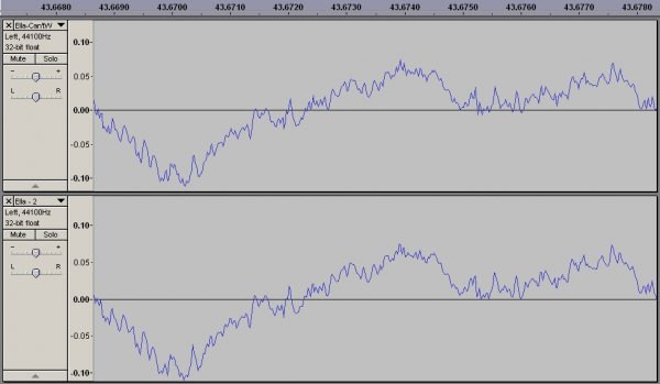

I mentioned earlier about an area of significant variation between take 1 and 2 of the Ella files at 43.68 secs: here is a view of that piece in Audacity. It may not appear that dramatic, but note particularly the greater level of high frequency "wiggles" in the 1st sample:
Frank
