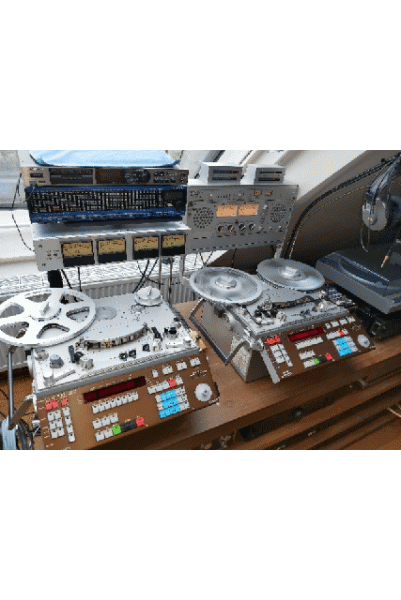

I listened today extensively to the nagra T audio.
Hands down the best tapehandling and best built machine i ve seen so far .
Its like a swiss expensive watch what a precision enginering , and both factory maintained
Soundwise the Studer B 62 is the champ
