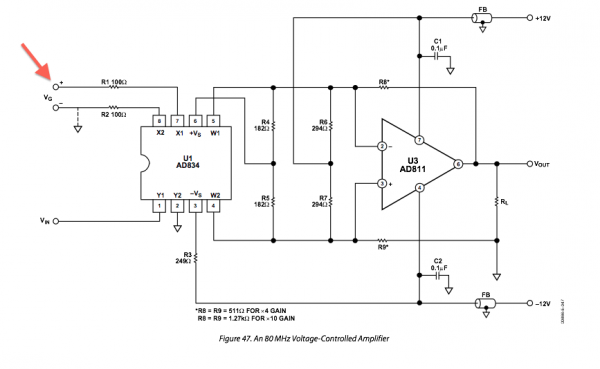

According to page 15 of AD811 datasheet http://www.kynix.com/Detail/918337/AD811ARZ.html, it can be used as a voltage controlled amplifier in conjunction with AD834 . In the schematic below, I am a bit confused about the configuration.
If we assume that W1 and W2 are in phase shift=? and supplied by AD834 internal Open collector transistors which are configured as common emitters by external resistors, it easy to understand that AD811 is working in a differential mode. VG stands for gain control voltage ( between 0-1v ?) and I think Vin must be the input signal. but what I can not understand is the + point in the schematic (red arrow in the schematic below).
What is this point connected to? it can not be V+ because 12v is well above the maximum ratings for inputs (page 4 of AD834 datasheet: with 11mA in Vs+ and R6+R4= 294+182? , we have 5.2v drop in VS pin but the maximum allowed Vin is equal to Vs). On the other hand AD834 is designed for working in +/-1.3 clipping voltage between X and Y and a positive voltage above 1v on this pin simply goes to its clipping region.

1- To where the indicated point is connected?
2- On page 15, line 10 of AD811 datasheet, it says that the gain is -70dB for VG=0 dB and 4 for VG=1 volt. I think this dB is a typographic error. If it is really dB and not volt, it may mean that for gain=-70dB we need to connect Vin to VG. Is it correct?

Hi Amandali, it is not clear what you want to do and what your level of knowledge is, but I hope this helps. Do you know the difference between a differential and single-ended input? If not, we need to clear that up in another post.
1- The X input is the multiplier and it is differential in this diagram. X=(X1-X2) The red arrow points to the X1 (positive) input for X. The differential voltage X can vary from -1 to +1.
2- I think you mean page 12, and yes, the dB is a typo. It should read:
"Using feedback resistors R8 and R9 of 511 ?, the overall gain ranges from –70 dB, for VG = 0 V to +12 dB, (a numerical gain of four), when VG = +1 V. The overall transfer function of the VCA is:
VOUT = 4 (X1 – X2)(Y1 – Y2)"
In that diagram, Y2 is connected to ground (0 V), so Vin is single-ended.
You would never connect Vin to VG, unless you want to use the AD834 as a four-quadrant multiplier and you want to square the voltage: Vout=VG * Vin
