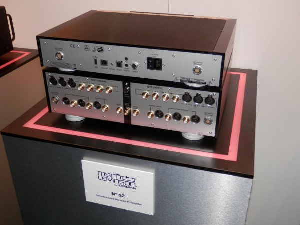

The only high end preamps I can find which are capable of doing what I want are the the Mark Levinson No.52 ($30,000) and the Krell Illusion ($$$$$$). Both of these preamps look excellent to me. Of course, I am soliciting you folks for advice for other units of which I am not aware. I am not interested in mediocre home theater preamps.(eg. parasound p7). I am not interested in any other digital volume control solution as I feel the one I am using is about as good as it as it can get.

It's definitely a four channel system.
I read the manual. The 53 would work.
Actually my mistake its the 52 not 53 which is the amplifier. The 52 is only a 2 channel stereo preamp, a Left & a Right not 4 channels and if this is what you're looking for then you have quite a few less expensive options to choose from.
david
It does 4 channels. Check out the manual which addresses the aux out. It is designed for my application. There really aren't many other options other than home theater pres and custom tvc like music first. I do think the devialet looks appealing but that would require a bigger system change.
I'm just trying to help Michael, not looking to score points or argue. Levinson's own description tells you what it is; dual mono means just that, 2 channels and not 4. How do you go from 1L & 1R input to 4 channels output? Its still the same 2 channels, L & R coming out of multiple outputs, nothing more. The Aux in/out feature is like a glorified tape loop that many other preamps also have.
