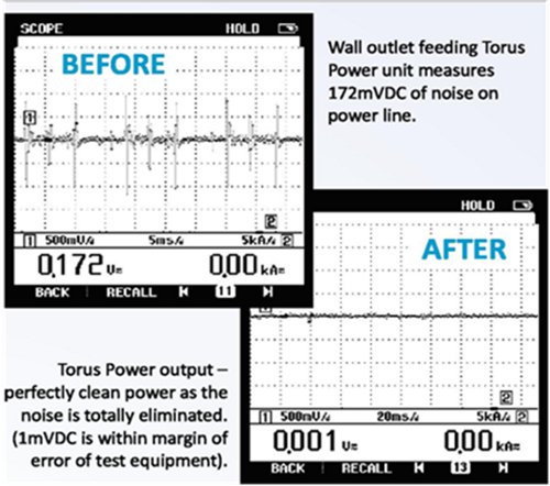

NBT from Torus is well done. They have a unique approach to clean things up.
http://www.toruspower.com/narrow-bandwidth-technology-nbt/
First: 172 mVDC is incorrect. The noise is an AC voltage.
Second: This type of measurement needs to be made at the amplifer's AC power connector while the amp is sending a reasonable signal to a dummy load or loudspeaker.
Third: A much better test is to examine the signal-to-noise ratio differences at the amp's speaker terminals.
IMHO no. DC offset in mains can be considered noise and I think it is what is being reported - see the offset of the baseline. Surely there is also a periodic component, that needs a more complete characterization. Your suggested method would be meaningless to consumers - some amplifiers have high power supply rejection, the results would be very difficult to interpret.
Look for their patents - they explain a lot more than the audiophile marketing pages! Looking from a technical point of view, in case we want an isolating transformer, these are the ones to own!
I like the idea of the Torus with an isolating transformer, but it has 6 outlets as I only need two. It's still too big. Why can't they make this for just one or two components?
