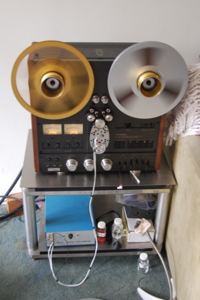

Charlie King was gracious enough to come over today and do part two of the mods to my Technics 1500. Charlie put a Pro Nortronics narrow gap head in the Technics headblock, aligned it and then checked FR. In addition, I opted to bypass the 2/4 track switch as really have no interest in 4 track tapes :) Again, less in the signal path!
Here are some pics of the deck now.
So far so good :) The new PB heads are far, far better than the stock heads. Better extension at both extremes and resolution. So far what I find shocking is the depth and tightness of the bass! Going to play them for a week and let them break in a little as Charlie suggested.
Part 3 will come in a month or so when replace the Mundorf with Dueland caps. Charlie will probably also take out the output cap - -as Mike L. suggested -- no cap is better than any cap.
