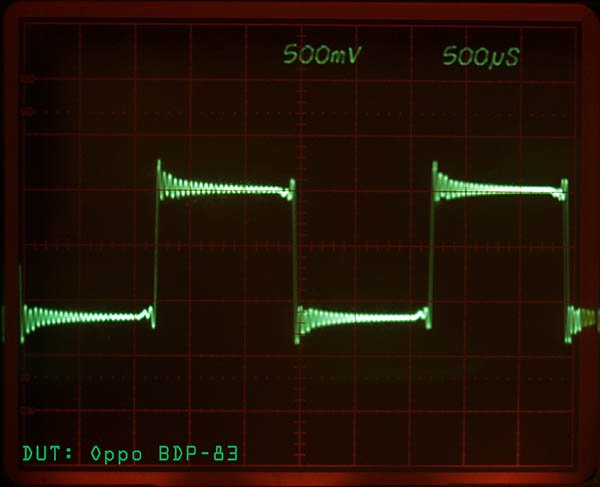

As part of my scientific inquiry into the sound quality and accuracy of equipment in my listening room, I measured the much-vaunted Oppo BDP-83 audio outputs with a 400Hz square wave on a test disc.

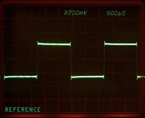

I also output a 400Hz square wave from my reference DAC. The test is stacked a bit against the reference, as it passes through a mixing desk AND my preamp, whereas the Oppo was measured off my preamp, without the additional cabling and audio stages of the mixing desk in the way. I can state that I've measured the Oppo outputs in the lab, directly, and they look the same as what I'm seeing off the Oppo --> preamp hookup.
The main issue here is that the Oppo's Nyquist filter rings like a bell.
Let's compare. Here is the Oppo:
Now here is the reference DAC, which is also running through my entire chain, plus 50' of poor quality cable (and still almost faithful to the original) to my preamp:
Needless to say, the Oppo's square wave response is very much remeniscent of first-generation CD players from 1983.
So why are people so worked up about the sound? It's probably because the Oppo is adding something to the sound, perhaps a series high frequency overtones which, for some reason, are harmonically-related to the music and thus not unpleasant. But I can't say that it's a faithful representation of the source signal.
With complex musical material, this sort of distortion may color the sound in ways that would be hard to predict.
