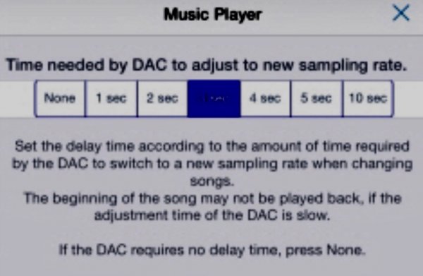

I played it from an Aurender N100. Aurender has a delay time option to avoid those clicks.
Forget it and enjoy !!!!
Stereophonic, can you please explain how the delay stops my DAC from clicking. If i can do that with my SoTM sms200 ultra it would be just the ticket. Does anyone here know whether that is possible?
