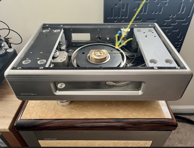

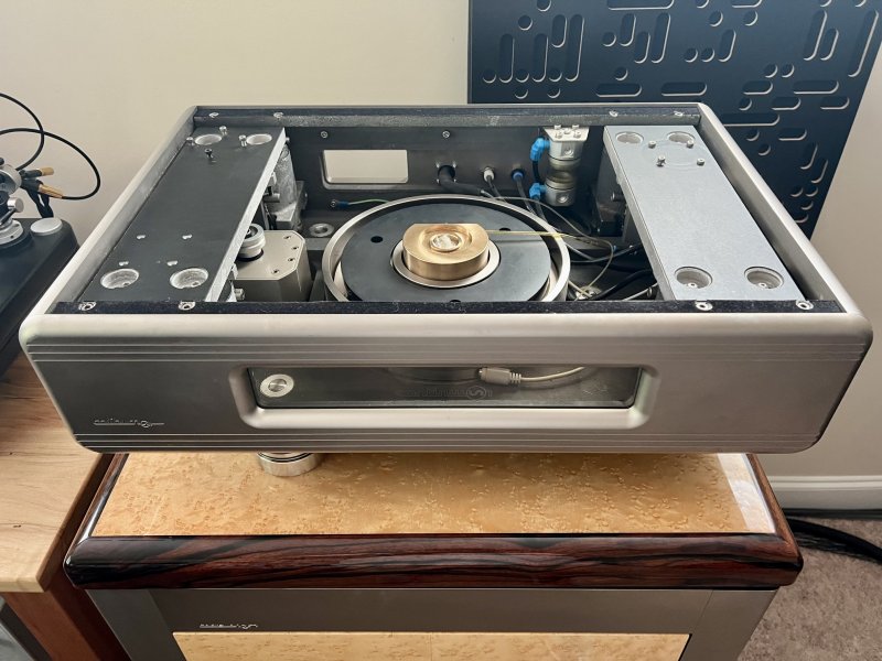

Setup proceeding nicely but at this level of heavy build, it’s a two person job. You have to set the motor up and lift the 100lb table over it. Next we will place the platter on the bearing, then add belt and check speed stability, then add tonearm tower to armboard, set plinth, build tonearm tower, add Cobra arm, and finish with cartridge setup.
Reactions: KeithR and tima
Well the good news is that the electronics are in working order. We added two new 12V marine batteries to the controller box and the vacuum, oil pump, and motor performing smoothly.

Nice turntable! Just curious, is this black disc the magnet to levitate the platter? If so, it is of similar size to that of the JC Verdier!C77D0581-67AA-41E7-8BBE-B57CDA91D34F.jpeg

Nice turntable! Just curious, is this black disc the magnet to levitate the platter? If so, it is of similar size to that of the JC Verdier!View attachment 112801
Good question. It’s a large magnet. There is also one under the platter and this pairing lowers the platter downforce to 6 lbs which is optimal for the oil pressure supplied main bearing. The bearing shaft is roughly 1” in diameter.

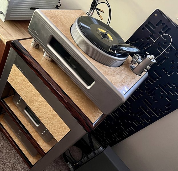

Is that a wrapper around the plinth or just on top of it. Not sure what I'm seeing here. Lovely ... birdseye maple? It appears to match the stand.
Sounds like you're having fun!
It’s a piece of sheet metal with a French maple veneer. Just for appearance.
